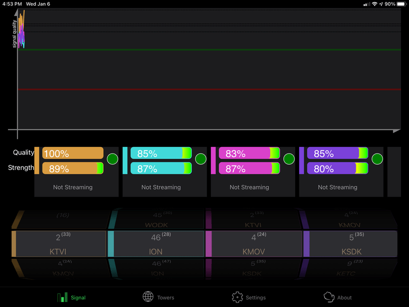

your signal strength is pretty low.
Jan 06, 2021 17:35:01.994 [0x7fed9d7fa700] DEBUG - [Grabber/25.11-z5fh40gta9no5syvc8h6sco9] Grabber: Signal information for tune on channel 25.11: strength: 24, quality: 59
for comparison, here is a channel from my dvr
[Grabber/11.3-2728BD16-1DC1-41F5-B3F7-021EB47A4555] Grabber: Signal information for tune on channel 11.3: strength: 84, quality: 82
I would recommend investigating a signal strength tracking app, like for example I use an IOS app called “Signal GH” which shows me signal strength on all 4 tuners using different selected stations.
I just noticed version 1.21.1.38.76 is out. I just upgraded to that and will see if the crashes stop.
well if the problem is low signal, no update is really going to fix it.
you may need to adjust your current antenna, or invest in an attic or roof antenna.
