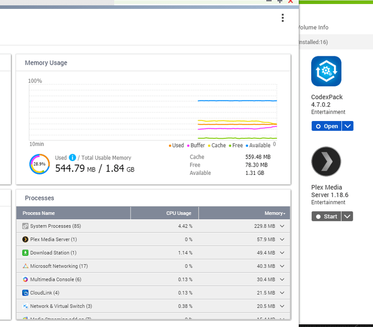

I met the issue again. The following is in the GUI with like 10 minutes after stopping Plex from the GUI.
I just updated the Plex to the current latest version 1.18.6.2368
Also, I can see this:

Are you using Plex + Multimedia share + Codex Pack?
If you mean by that, that those are installed on the QNAP storage, then yes.
If I force kill the process, then I can start Plex up again without issues. But I suppose this is not the normal behavior.
I see from your screenshot that Codex Pack is installed. That is obvious.
I am specifically asking if you’re using the Multimedia share as the reference point for Plex.
If so, you need to stop using it that way. Here’s why:
  1. The Multimedia share isn’t a real share. It’s a software construction (API) . The Codex Pack changes those pathnames dynamically.
  2. It has been well established PMS, especially transcoding, optimization, and DVR, will not work well destinations under the influence (which are dynamic) of Multimedia and Codex Pack. Both those APIs are very QNAP-centric and always have been.
