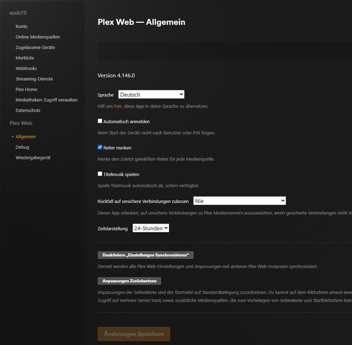

Help! I’m having the same problem. Running fine on MAC/iPad/iPhone/AppleTV since 2021. but since the PMS update v.1.41.7.9823-59f304c16 May 24, 2025 have lost everything. Tried eveything in support but no luck. Sorry guys but i’m not really savey with all the jargon above, just hoping someone can solve this for us simpleton’s.
Read all about it here: https://support.plex.tv/articles/206225077-how-to-use-secure-server-connections/
And yes, DNS rebinding protection would only affect connecting to a local Plex server within the same LAN.
It has no influence on connections to *.plex.tv, nor on remote Plex servers.
