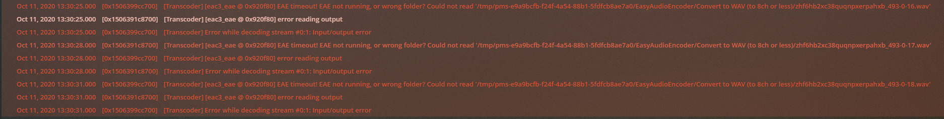

For some reason when I watch ALL logs in the console I see the error in the image below, which are not in the debug log at the bottom. Does anyone have any idea what is going on and how I can fix it?

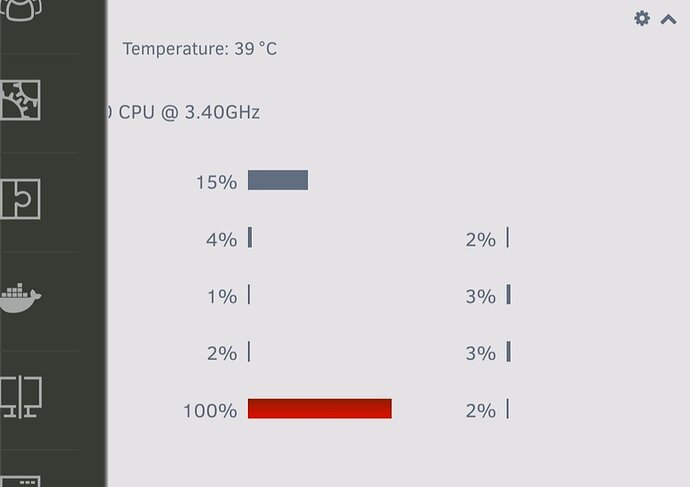

This happens to my cpu cores, it goes to 100% and switches. Sometimes starting a different show makes to seem to make it go away. But starting The Boys again makes it bug.

These usually mean that you’ve run out of inotify watches. You need to increase the limit in your system configuration or reduce the number of watches in use (such as disabling the Scan my library automatically pref).
How is that even possible to have to many watches? It’s a fresh linuxserver container with maybe 10 shows and 200gigs of movies. I lost like 5 TB of shows when I swapped to unraid, and never had to many iwatches before :S. I manually refresh libraries too.
When I run “find / /movies /tv -type d -print | wc -l” in both docker and the host i have about 145k directories. The iwatch limit is 545k.
