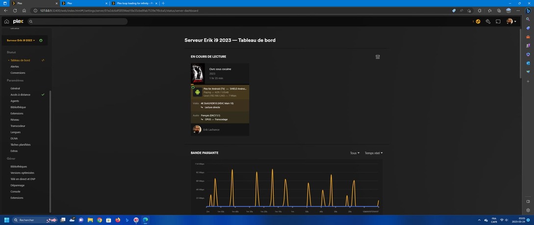

Interestingly, when this happens, the activity on the server shows that the file is playing. Could you please assist me in resolving this issue? Thank you.
Plex Media Server Logs_2023-03-24_01-43-58.zip (480.6 KB)

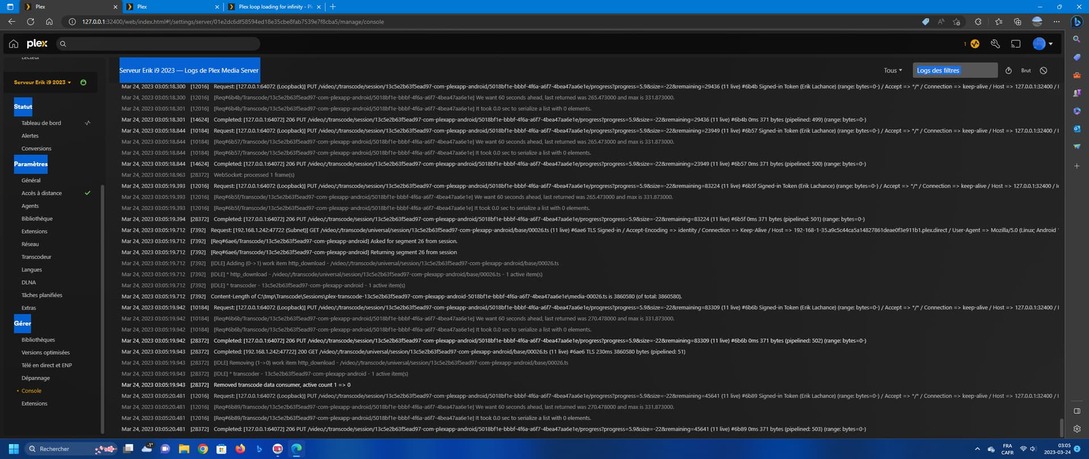

here i play the files , the trailer start after it stuck at loading, after i set in 720p and original
i enable the full log and i see someting strange now it work if i disable the subtitle !!!
