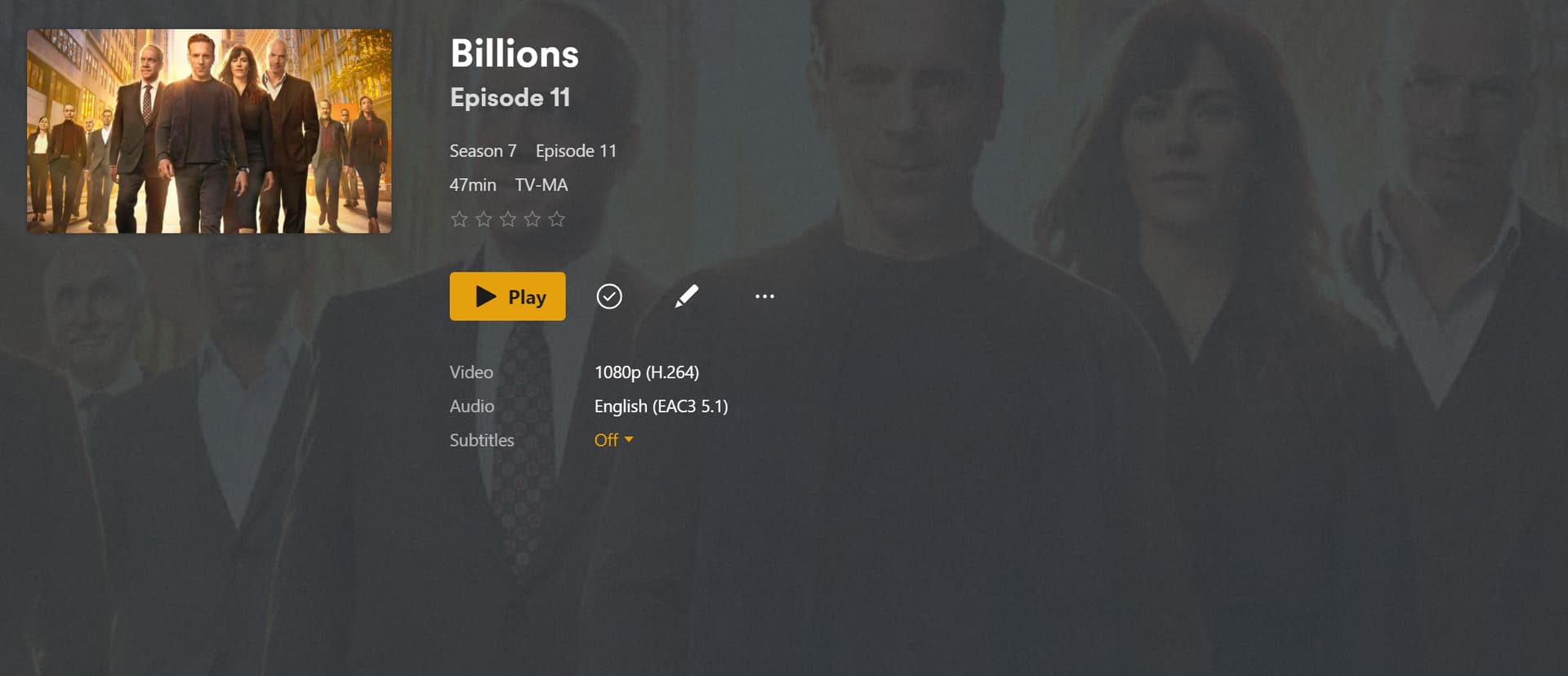

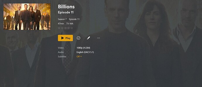

However, around Thursday (10/19), when any type of media file gets added to Plex, none of the media metadata gets added.
Regardless of how many times that library gets scanned. No changes on my end happened in terms of changing media agents.

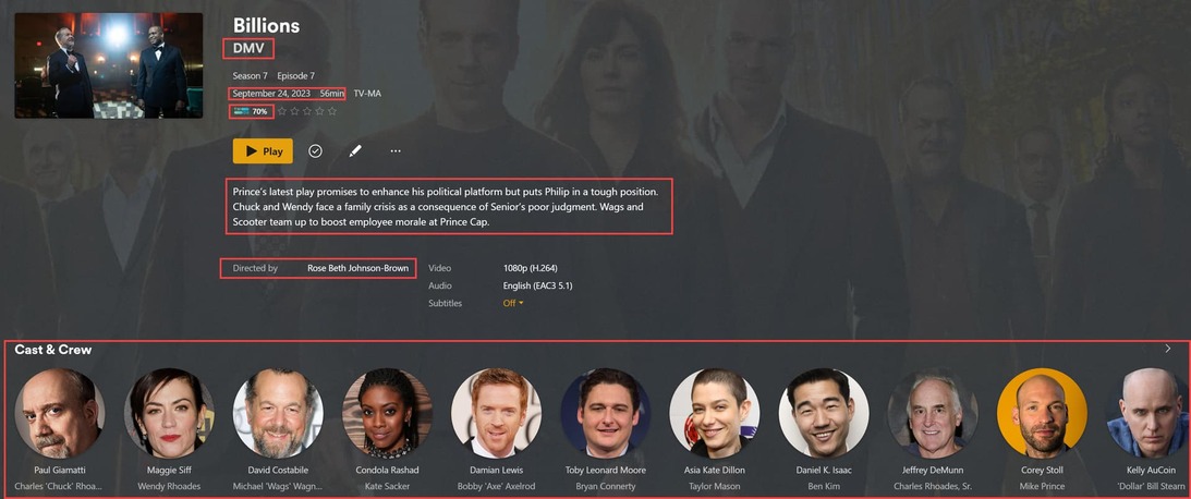

Btw, this is what it should be populating (this is a previous episode), when the media metadata was working.

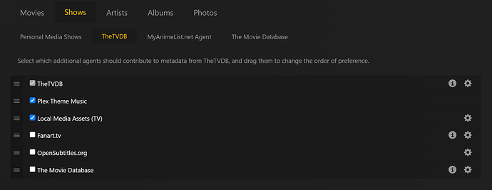

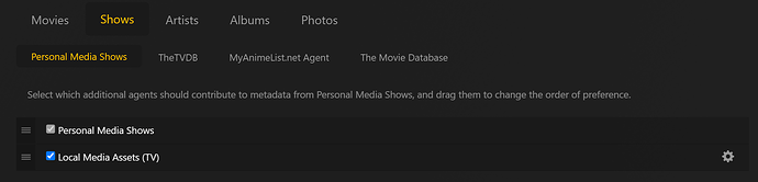

Are you using the standard library agents?
Here are the server logs. No, I haven’t modified the library agents.
What was being used a few days ago remains the same during this particular time when the metadata isn’t working.

Your example is an episode that just aired and the metadata for that episode was just added to TMDB and TVDB recently. It can take up to 72 hours (3 days) for updates on TMDB and TheTVDB to propegate down to Plex. Give it another day or two then refresh the metadata for that episode to see if it populates.
Also, have you simply tried restarting your server?
I’ve tried restarting the server and I don’t think that helped. Although you look to be correct with the TV episode, normally when I add a show that came out that same day, the metadata normally populates the next day. These batches of newer episodes (I have 3 different shows I added on Thursday that are having the same issue), could be taking longer than usual, I’ll see if the metadata populates after a few more days.

While an episode has been out for a while on TVDB/TMDB, Plex now loads metadata for its episodes from it’s own service that scrapes those two sites (and IMDB?). So the best way to find out if Plex can load metadata is to load up watch.plex.tv, and look for your show there. I used that to verify that Billions S07E11, shown in your screenshot, was on Plex with metadata. I assumed that you had refreshed your metadata recently and still had no data, so I thought maybe we need to look elsewhere for info.
