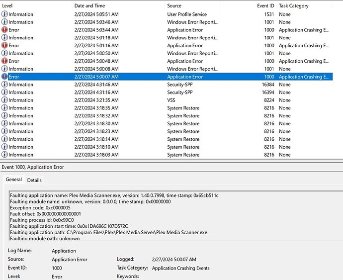

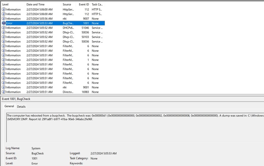

I wish to find the cause. Subsequent crashes leading to bugcheck every morning during maintenance period.

I found a lead to the first file that kept my Plex Scanner crash in the error log files from Plex.
Take a look and see if you maybe have the same issue as me?
That there is one or more files that makes the scanner crash? :slight_smile:
