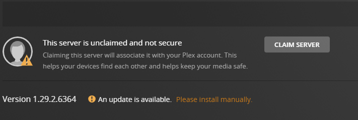

I’ve been running a Plex server for the past 2 weeks and with the exception of the occasional metadata not displaying, I’ve had no issues with it. Today, suddenly, I was unable to access the server anymore.
I logged in to it just fine at about 9AM and then at around 10-ish when logging into the web portal, it kept saying that the server is unavailable.
I am running the server on a Synology DS923+ and I have initially updated the server to v1.32.
Nevertheless, since this morning I’ve installed and uninstalled the server more times than I can count, trying to fix this access problem.
At one point I got it showing the server itself, however, as it appears in the screenshot below, I can’t claim it. I click on the button and nothing happens.
The logs show at one point the error “Could not resolve host: plex.tv”, however, the website is accessible from all devices in the house. I even reset the router thinking it’s a DNS issue. It can’t be because port forwarding is activated on the router, the NAS has a static IP, port 32400 is set under port forwarding on the router… I honestly don’t know what else to try/do.
Can anyone help?

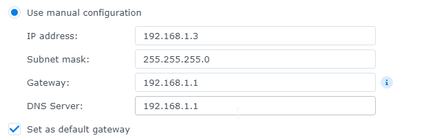

One thing you probably overlooked is the DS923+ itself.
It must also be configured to use your router’s DNS and as a Gateway to get to Plex.tv
Go to: Control Panel - Network - Edit the appropriate interface you’re using.
If you’re using multiple adapters, Start with eth0 as this is the DS923+'s default and what PMS will use when multiple are connected. Also make certain to check the appropriate “Use as default gateway” checkbox.
We know it worked at one point but something must have changed in the Syno’s network configuration
Thank you for the reply!
I just checked the settings and no dice. Same thing happens when setting the default gateway :frowning:
Note: The manual configuration works for everything. All other services running: Radarr, Sonarr etc. are working without any issues with the current settings.
Only Plex has this issue and there have been no changes to the DSM version or other settings between the last time the server worked and when it stopped working :frowning:
