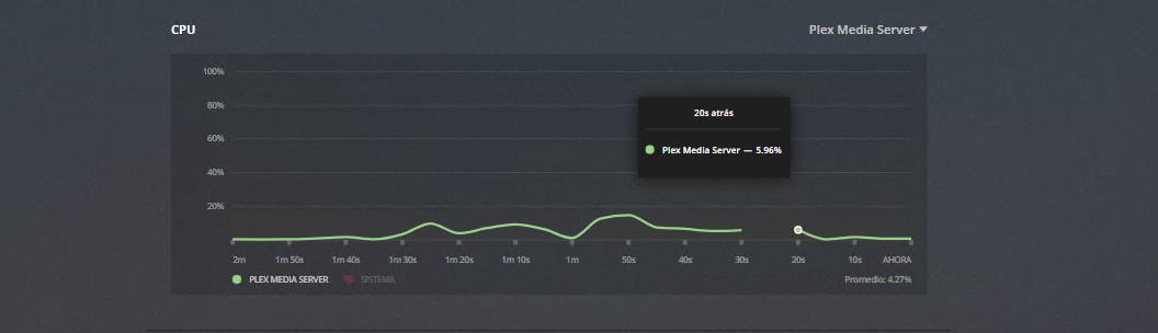

Hi nibbles thanks for your quick response
I attached this image, since I update it happens to me often
Any solution at the moment?
Daniel
