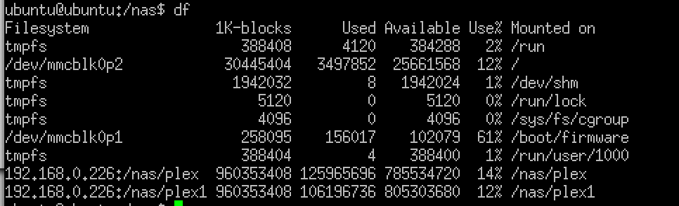

The NAS is set up with the correct entries in /etc/fstab and /etc/exports. The Plex server has the entries in /etc/fstab. I am seeing the correct items in ‘df’ as far as the nfs mounted directories. Both servers have user ‘plex’ and it owns the plex directories with full permissions. The mount point root is /nas on both servers.

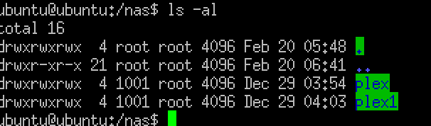

What are the permissions of the directories BEFORE mounting the NAS?
What are the permissions of the directories AFTER mounting the NAS ?
(same top level locations)

Permissions before mounting nas
After mounting

What the heck is user 1001?
You have a Linux NAS?
UID 1001 is the UID of the account you signed in with to upload the files.
Permissions look good too.

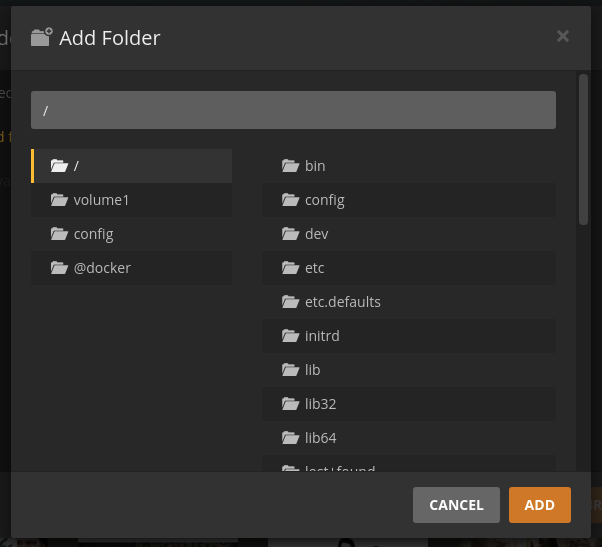

When I tried adding another series section I still don’t see the mounted directory rather I just see the information from my Mac.

Did you know you can type in /mnt2 and jump to it ?
I have no idea what /Users is. That’s not Ubuntu linux.

The other selections on the ‘Browse screen’ (/users) are the contents of my Mac. I couldn’t do that if i tried but I am just wondering how it got there??
You went TOO FAR into the directory
/mnt2/TV Shows is where you stop. That’s what should show in the Folder Name.

  1. sudo chmod 755 / (the root directory cannot be read)
  2. Now open it up and start browsing from /
  3. Directories to go into will be on the right.
  4. Scroll down to mnt2 and click it
  5. Scroll up and click “tv shows”
  6. Click OK.

I have no / to browse even when I change the permissions
This thing is not even looking at the Plex server but at my Mac. I switched back to my Raspbian server and re-installed Plex to no avail. How is the server ‘claimed’ and where does it use to select the directories (both to select and use since neither work)? Plex does not ‘see’ a flash drive on the Plex server either.

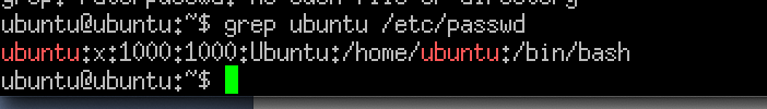

Open a terminal window.
type grep mark /etc/passwd (don’t worry - it won’t show your password.
It will show me where your home directory is.

I log in as Ubuntu, I suppose I should create my own user
