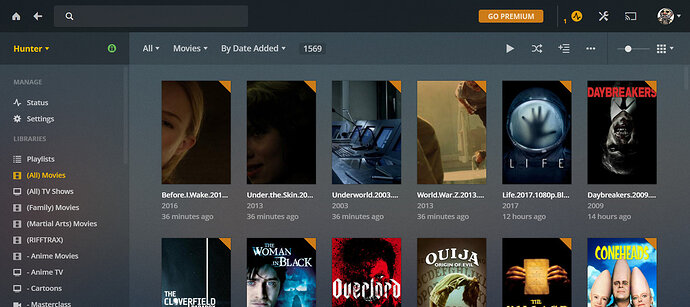

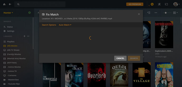

So, my issue started out of the blue this morning when I tried adding some new movies to my PC’s plex media server, but when they were scanned no metadata was scraped from my agents for the newly added films. I didn’t rename them in filebot or anything (though all my other files are the original file name they came with from yify or rarbg) but I’ve never had to before for my other 1800 films so I didn’t think it was an issue. So, after a couple scanning retries and refreshing metadata I decided to manually ‘match’ my movies, however when auto searching (or just doing plex movie and MDB) it just keeps loading and loading as if it can’t reach the Plex Movie database. So I figured it had to be issue on their end, but on my shield downstairs scraping for metadata and fixing matches works fine, only taking a few seconds to get a match.

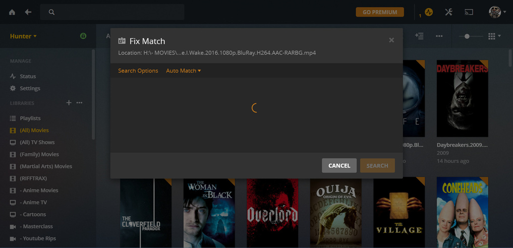

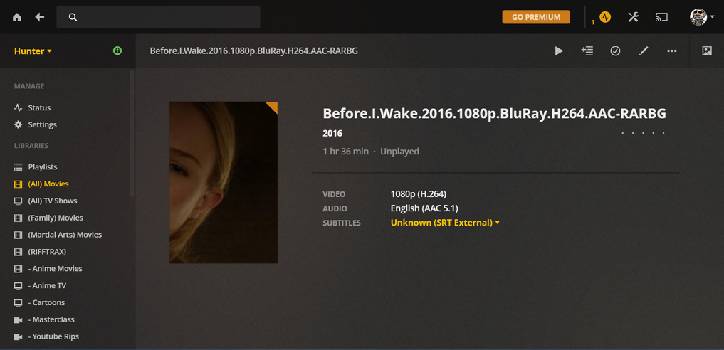

Thanks for the response, I wasn’t even really concerned with that file though, I noticed Life worked fine but I find it strange that it shows Before I wake was properly scraped as nothing seems to show up for it. And this doesn’t really address my main concern as any movie I try to match or fix match to won’t even show any titles to choose from, just stays with that rotating buffer sign indefinitely as seen in image #3. Would my logs show any issues my server has connecting to the movie DB or Plex Movie?
