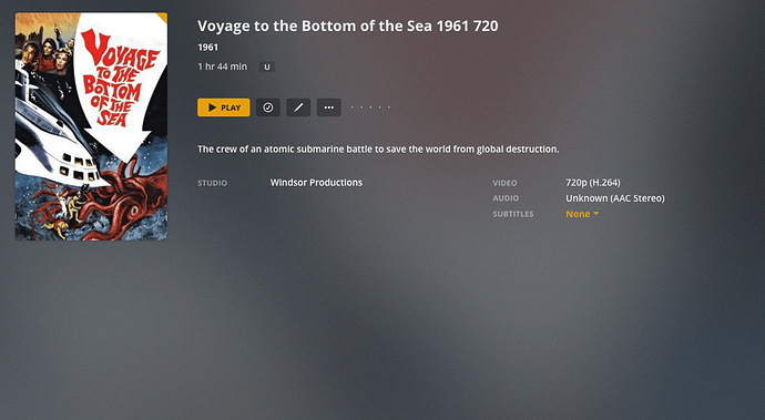

What’s happened. The agents were scraping the posters, casts and synopsis’ until today when I’m only getting the titles and sysnopsis. And certain movies refuse to scrap at all. This is very odd. Is there something up with the database?
Yesterday it was working perfectly now it’s broken . . . Gwangi was yesterday and Voyage to the Bottom of the Sea today. Something’s not right. I didn’t change anything, so what gives?
Seriously what’s going on? My system is no longer scraping movies I add properly. I need some assistance.

Another problem is that Plex Movie seems to be the only agent avilable, The Movie Database seems to be missing. I thought to software was perhaps out of date but apparently it’s all updated. Everything was working fine a few days before. Some movies just won’t scrape no matter how much info I give.

Have you checked the unmatched and duplicates filter within your library you created ? I’d imagine the movies are sitting in there. Taking a very quick look at your logs I can see many problems with the naming of your files. Just a few examples below:
  • [/Volumes/Seagate Backup Plus Drive/Hemel Odeon Server/The Hobbit -The Battle of the Five Armies (2014) 720.mp4]
  • [/Volumes/Seagate Backup Plus Drive/Hemel Odeon Server/The Silence Of The Lambs (1991) 720.mp4]
  • [/Volumes/Seagate Backup Plus Drive/Hemel Odeon Server/The Hobbit An Unexpected Journey 2012 3D SBS 1080.mp4]
  • [/Volumes/Seagate Backup Plus Drive/Hemel Odeon Server/The Lone Ranger 2013 1080.mp4]
  • [/Volumes/Seagate Backup Plus Drive/Hemel Odeon Server/The Lodger (1927) Special Edition 720p.mp4]
  • [/Volumes/Seagate Backup Plus Drive/Hemel Odeon Server/The Grand Budapest Hotel (2014) 720.mp4]
I’d say this is why some stuff is being found and others not. Your file names are unfortunately poorly named so plex is having trouble matching them.
I believe stuff within () are ignored and used for year matching when duplicates are found with the movies with the same name. Regardless, I’d imagine how you have named The Lodger as an example is most likely being searched for as The Lodger Special Edition 720p and then no match found.
