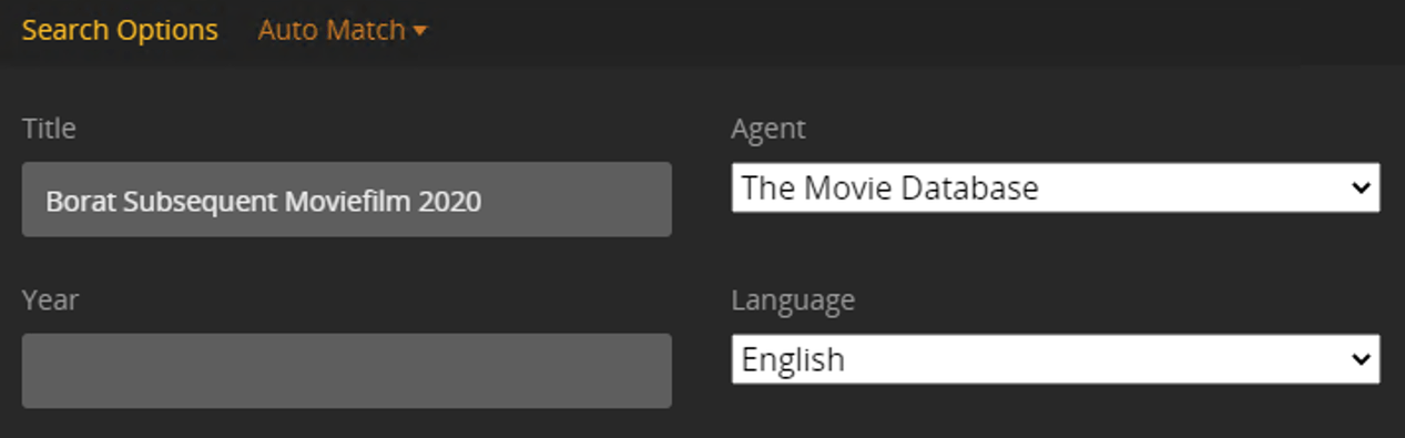

I have issues with the matching as well. Works fine if I move the year from the name from the Tile to Year. The file name is {Movie Title}.{Release Year}.{Quality Title}. Any ideas?

Thanks. I did what the article suggested, but it still wont match my movies correctly. Example what I tried with: The Movie Title (2010) Bluray-1080p. Could it be the quality title that messes things up?
It could be.
You can try adding the technical stuff in square brackets, e.g.:
The Movie Title (2010) [Bluray-1080p].ext
Alternatively… if your library is using the (new) Plex Movie scann/agent… you can include the IMDb or TMDb id in your folder or file name, e.g.:
The Movie Title (2010) {imdb-1234567}.ext
or
Movies
  The Movie Title (2010) {tmdb-12345}
    The Movie Title (2010).ext
I will give that a go. I noticed that the year is now placed in the correct field, I.e. Year, but I still need to search for it manually.
No luck with The Movie Title (2010) [Bluray-1080p].ext. How do I configure the new scann/agent?
