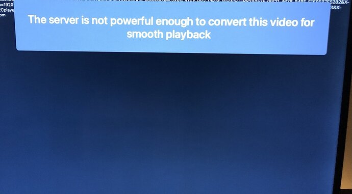

Dears,
Is there anything I should set up on my plex server NAS Synology or media player on Apple TV to play video I have problem with?..or its just to “hardcore” video for that piece of equipment?
0111
Im getting message my server is not powerful enough to play the video.
Im able to play that video on my iphone X without any issue but Apple TV is not able to handle it.
When disable transcoding my Apple TV is not able to handle the video (a lot of stuttering)
Thank you!

That’s weird cause while loading and before playback I am getting communication that my server might not be sufficient enough to play the movie and after a few seconds movie runs but with poor playback quality.
I see my CPU is loaded usually 30-50% so believe there is more power still
Unless something wrong is with the file itself cause even if turn off transcoding the apple tv device is not able to handle the movie. Movie runs like in slow-motion. But from the other hand my iphone is able to run that file through plex so really do not know :confused:
