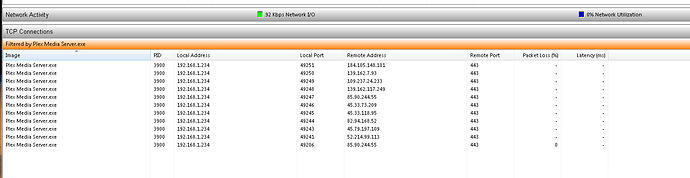

After starting my Plex Media Server i have a look in the Resource Monitor to check the Plex network activity and I see that there are a bunch of active connections to remote addresses. This is probably normal, but I just want to understand what is going on. I thought Plex used port 32400?
I also want to restrict the internet traffic on the server where my Plex Server is running to allow for Plex only. Does anyone have any knowledge on how to configure this on the Asus RT-AC66U router, or similar?

Plex Media Server does establish connections to crash reporting server, to the Amazon AWD servers where plex.tv services are hosted and pubub servers which appear as linode servers. There are other systems Plex Media Server connects to for metadata

@sa2000 Thanks! I guess that answers the first part of my question. So if I understand you correctly TCP Port 32400 is used when I connect to the server from e.g. a Plex web-client, and the other ports in use are for the Plex server services connections to remote 443 ports. Is outgoing data (e.g. video stream) back to the web-client also using the TCP 32400 port?
