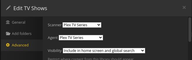

Not sure why they are not appearing for you in the UI. Unless there is another suggestion I would suggest making sure the scanner and agent is set to the Plex TV Series, even if they are change the agent one to something else in the drop down and then set it again which will auto update the scanner one and save. Then stop plex, start it again do a scan and attach a new set of logs if the problem is still happening.

Well, I think you’ve only gone and bloomin’ done it!
Switching the agent, switching back and giving it a restart seems to have done the trick.
All the missing items showed up right away.
I am most grateful indeed.
