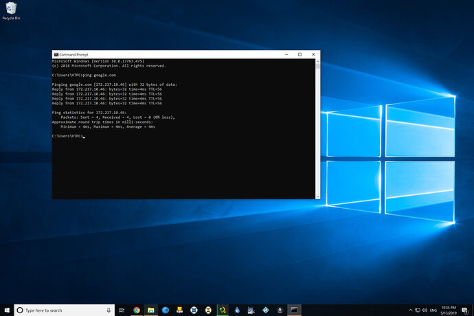

open a command prompt again and try to run these commands and post the output
ping app.plex.tv
ping plex.tv
ping google.com
ping 4.2.2.2
here you go.
That’s weird…
