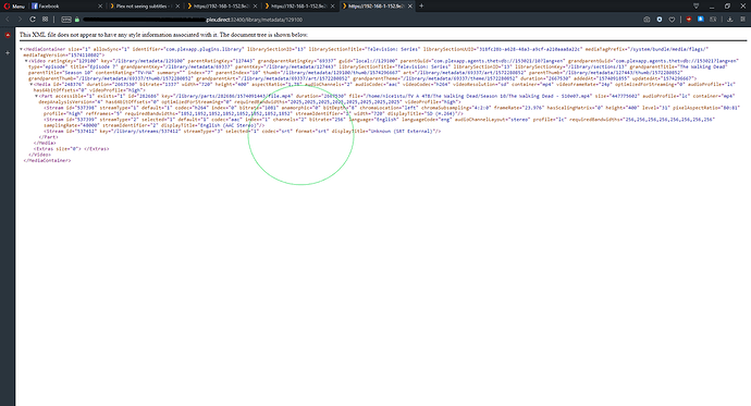

But I noticed this going thru the XML files. I have no idea how it works or how to edit it… but I noticed the difference between the files with working subtitles and the ones that don’t. Maybe someone with more knowledge can have a look and solve the problem. Seems to involve the Stream id.
No Subtitle:
Working Subtitle:
The XML doesn’t make any difference. It is just a different presentation of the same stuff you see in the regular user interface.
The first screenshot just tells the fact that no external subtitle has been recognised. Nothing else.
Oh damn… thought I discovered the cure for cancer. HAHA. Oh well… I tried.

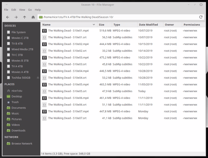

Can you switch the view mode of the season folder (in your file manager) to a kind of “list mode”?
So one can see all the file names neatly aligned under each other. Sometimes you notice differences that way, which escape your attention otherwise.
I am missing the file permissions somehow. This is Linux, right?
Yes this is Linux Mint 19.1. I will double check the view options
