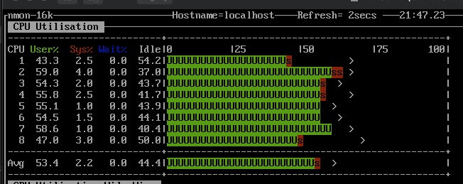

I have a plex virtual machine and I have tried with 4 CPUs and 6 CPUs and 8 CPUs assigned. However when I play a movie with a high bit rate and it attempts to transcode the video for the player it does not use all the CPU. I will try to upload a screen shot using nmon on server during transcode. The play back stutters and hangs. I would expect that the cpu would be 100% if it didn’t have enough power.
I have also set it to 8 CPU and the total use of the CPUs sits about 50-55% of use.
Why is plex not using all the CPU % available? is it worth to continue to try different linux distros?
Has anyone else seen this behavior?
Screen Shot 2021-11-24 at 9.47.23 PM
You’ll never use every single bit of the CPU.
Transcoding is multi-threaded.
  1. Input demultiplexer thread
  2. Video decode threads
  3. Audio decode threads
  4. Subtitle burning thread (if subtitles are burning-n)
  5. Subtitle conversion thread (if subtitle format is being converted
  6. Audio encoding threads
  7. Video encoding threads
  8. Output Multiplexing thread
All of which must stay in time-sync with the resultant stream’s timing requirements.
The OS CPU scheduler is going to bounce the threads around to the next available core.
In the end, you’ll never have “100% saturation” due to the inter-stream data dependencies before the packets can be sent
You also have wait time inherent to memory and disk I/O.

Thank you for the info. So if I understand it correctly the memory bus on that CPU can’t feed the CPU fast enough. So the CPU can’t get to 100% usage because it’s not getting the data fast enough do do any processing. I guess it’s the type of data the HEVC is that doesn’t allow the pipline to run at full 100%.
If I’m not saying that correct you can correct me. I just like to understand in somewhat normal speak terms of the issue.
I wish I could just throw more cores at the problem.
