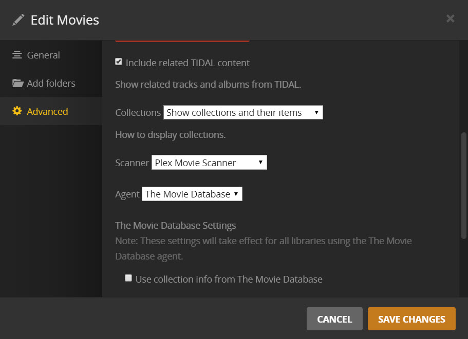

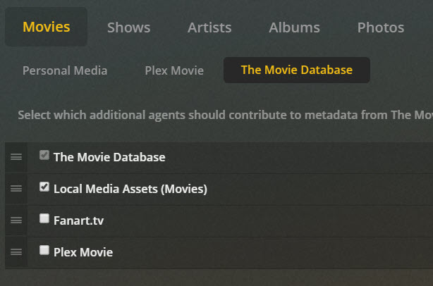

What is your agent stacking order for movies and which agent is selected in the library section please?
Also, did you change to TMDB before or after initial match?

Sorry - I hadn’t kept the change to TMDB, so those are the logs with PlexMovie.
Here are the logs after changing to TMDB and refresh of all metadata.
Plex Media Server Logs_2019-11-29_17-17-37.zip (1.5 MB)
PlexMovie TMDB
PlexMovie
TMDB
