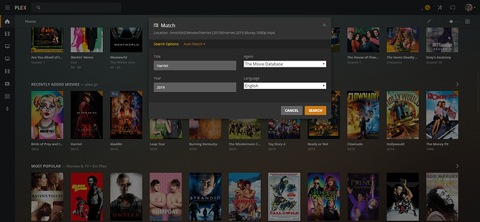

No matter what movie I try to query:
THe Following Happens:
Mar 25, 2020 16:08:32.861 [0x9f7f3450] Debug — HTTP 200 response from GET http://127.0.0.1:38339/system/agents/search?mediaType=1&id=1939&identifier=com.plexapp.agents.themoviedb&lang=en&name=Harriet&year=2019&manual=1
Mar 25, 2020 16:08:32.861 [0x9f7f3450] Debug — [com.plexapp.system] HTTP reply status 200, with 130 bytes of content.
Mar 25, 2020 16:08:32.862 [0xb13ff450] Debug — Completed: [127.0.0.1:43756] 200 GET /system/agents/search?mediaType=1&id=1939&identifier=com.plexapp.agents.themoviedb&lang=en&name=Harriet&year=2019&manual=1 (19 live) GZIP 924ms 408 bytes
Mar 25, 2020 16:08:32.862 [0x90bfe450] Debug — HTTP 200 response from GET http://127.0.0.1:32400/system/agents/search?mediaType=1&id=1939&identifier=com.plexapp.agents.themoviedb&lang=en&name=Harriet&year=2019&manual=1
Mar 25, 2020 16:08:32.862 [0x90bfe450] Warning — No matches for search.
Mar 25, 2020 16:08:32.863 [0xb13ff450] Debug — Completed: [192.168.86.237:52709] 200 GET /library/metadata/1939/matches?manual=1&title=Harriet&agent=com.plexapp.agents.themoviedb&year=2019&language=en (18 live) TLS GZIP 938ms 561 bytes (pipelined: 23) <

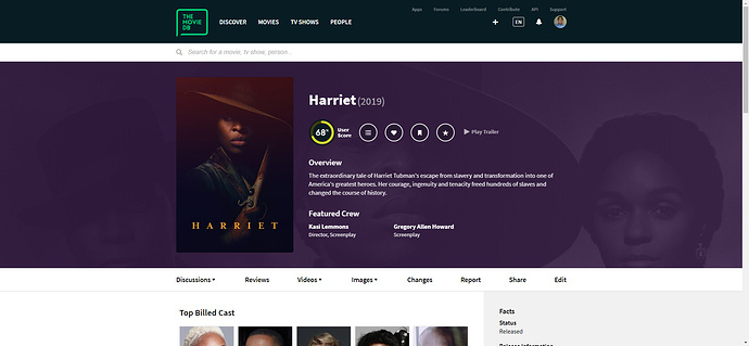

But when I got to the TMDB directly it seems to be setup:
I’ve followed some instructions in other posts where they recommend swithcing of IPv6 Networking and restarting plex server, already done this. I don’t really want to do the whole Plex Dance thing, beacuase I’ll end up loosing alot of my playback history and probably user configurations and so. Don’t think its a network issue because I can access the plex server from outisde the network perfectly, and metadata for TV shows as I’ve mentioned before works great.
