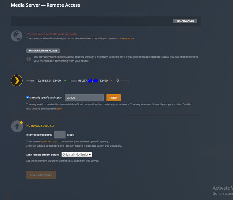

everything was working fine and dandy until the update. Once it finished updating I have been having a few issues. Plex refuses to stay connected. I go to remote access and have to press retry once every few minutes. My network config has not changes at all. However just to eliminate any issues I factory reset my netgear Nighthawk XR1000. I made sure UPnP was enabled I also forwarded the correct ports and still having this issue. I have rebooted the pc and still same issue
Plex is running on a dell poweredge rack mounted server, OS is windows server 2012 R2.
I have tested this out using my phone and a friend who lives about 60 min from me. We can access my plex library however its indirect even though it says my plex server is not accessable outsite the network. I have spent the past 8 hours trying to figure this out and frankly getting rather pissed off since this only happened after the update and was working fine with no issues what so ever. I also have the firewall on the server turned off as well just to make sure its not a firewall issue. Logically there shouldn’t be any issues but its refusing to work the way its suppose to

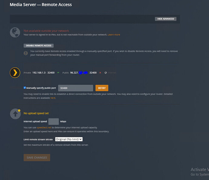

Here are a few screen shots:
as a hail marry pass I DMZed the server and its still having issues, what the hell is going on?
UPDATE: I switched to a my ISP router and having the SAME EXACT issue. Factory reset the router and again same issue. I am an hour away from uninstalling plex altogether and call it quits
