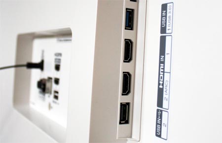

Firstly LG do not support DTS in 2019 and 2020 models, secondly there is no Plex app software on the TV. The TV is a WebOS device therefore all apps are remote. What is on the TV is a loader to activate the WebOS app
As for eARC, will it transfer DTS to a supporting Device via a Ethernet port. I can not find any supporting argument. What I have heard, that from a HDMI 2.1 cable and port a supporting Player like a Nvida Shield or Blu Ray Player, eARC will pass thru DTS-MA.
So I definitely don’t see where Plex have failed or been delinquent for that matter, where LG dropped DTS support due to Licensing or whatever. The LG HDMI module supports the pass thru but I would guess the LG firmware does not support the transfer from Ethernet or WiFi, which is the normal passage from a networked TV connection. A supporting network HDMI device connection is the answer not Plex bashing.
Read the following LG support article.
