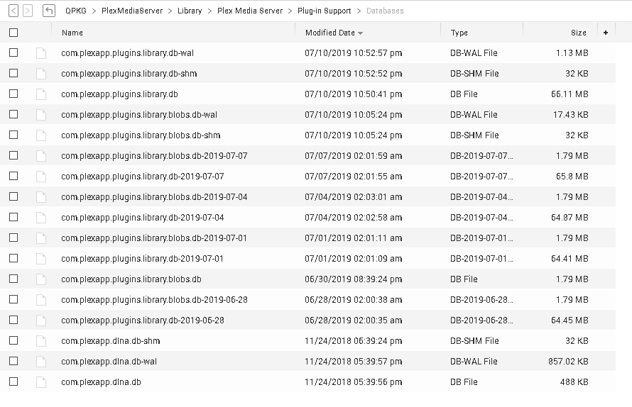

I would also like you to drill down into the PMSLibShare into Plugin Support/Databases.
please look and see if you have a large WAL or SHM file .
If you do, then we’ve found it.

That said, treat me like I’m a total newbie… Where is the PMSLibShare found? I’ve got QPKG>PlexMediaServer>Library, but nothing specifically what you’ve cited.
NM… Found it… QPKG>PlexMediaServer>Library>Plex Media Server>Plug-in Support> Databases
Nothing huge, but I did restart PMS shortly after reaching out with my post this evening. I suppose I can check this if the mem goes vertical again.

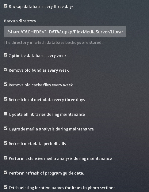

I went to scheduled tasks and see:
So, unless you turned it on, it’s somewhere else, or it isn’t respecting the check box, there may be something else going on?

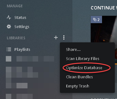

And for the newbies who may be reading this… How do I manually optimize the DB? And how do I verify that it is scheduled to run?
Sorry to be such a pain. I’m hoping this is it.
ETA: Found the manual optimize under library options:
to make sure it’s actually ON.
Off - save
On - save
I have seen it miss because of updates

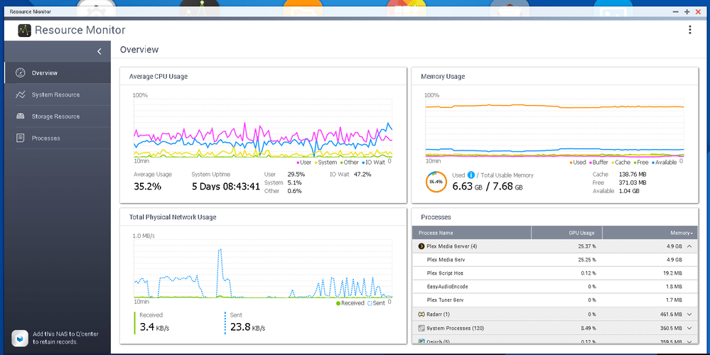

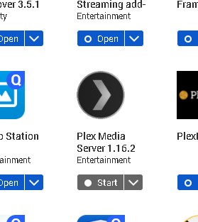

This evening PMS became unavailable again. QTS shows it’s running at near 0% CPU, and only 60-ish MB of memory. For a quick fix, I figured I’d just stop it via the app center. And, after a few seconds, the app center reports it as stopped - however, the resource monitor shows it very much still running. Short of rebooting the QNAP, I don’t know how else to get it to shut down.
Resource monitor:
But don’t tell the App Center:
ETA: Using the App Center to restart Plex solved the immediate connectivity issue.

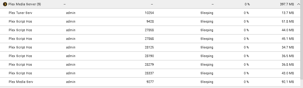

But, FWIW, since restarting Plex, the process tab now show 9 elements for Plex:
I don’t recall what it is ‘normally’ but given that no one is currently logged in or streaming, is that excessive?
