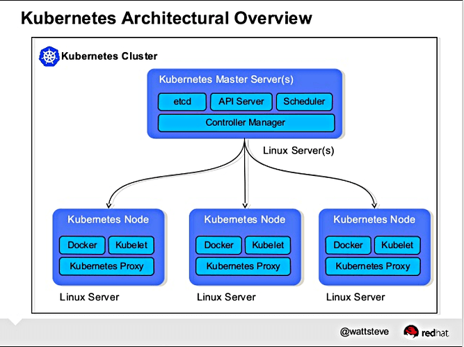

Plex is not designed for a multi-host cluster. It’s not intended for enterprise level architecture usage as shown in this image.
Plex is intended for single CPU or SMP-hosts which present as if a unified CPU architecture.
Kubernets represents an ASMP host arcitecture.
You are asking far more than it was designed for.
