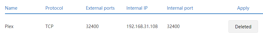

I am trying to set up Plex for Remote access. The following is what i have done till now.
I have set up a static IP for My windows machine where Plex server is installed.
I have also created a port forwarding in my router for 32400
But still i am getting error.

Change the port forwarding, so it only forwards TCP packets.
UDP is not used for remote connections.

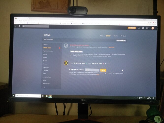

In the Plex web app, go to Settings > Server > Remote Access
put a check mark in front of ‘Manually specify public port’ and type in the ‘external’ port number from your port forwarding rule.
Click ‘Apply/Retry’.
Ignore any error messages at this point.
After doing that, restart your Plex server and let it sit at least 5 minutes.

I have changed the port forwarding to TCP.
I have restarted the plex server. I checked on that Check box and click retry to get the same error.

One more thing i noticed is that now when i click on Retry, for first few seconds its showing Green and says its connected but immediately it again changes to Red and throws the error.

Like this
And within secs, its changed to this.
Is it due to my firewall or something?
Sorry, don’t get your hopes up.
It shouldn’t go green at all before it has performed the accessibility check. That is a flaw in the status display.

On the canyouseeme website, it shows an IP address. Is this the same as what appears on your last screenshot above?
Yes the Ip address in the Canyouseeme website and Plex outside are same.
