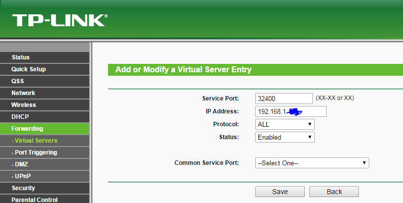

** But i have a lot of things to add, not what you just said, take a look of the screenshot i added
Hi
I am not completely sure if “Modify a Virtual Server Entry” refers to port fowarding, because I am missing the inbound and outbound port setting (normally you can set a port which is visible from the outside and then to what port it translates on the inside of the network)
But if this is correct use the settings:
Service Port: 32400 (and speficy this one in your plex server settings)
IP Address: Address of the PC where your Plex server is running
Protocol: Should be TCP but “All” will also work
Status: Enables
Common service port: I think you don´t have to choose anything there as it will only overwrite the Service port in the first field, but you can post a screenshot of the options.

I cant screenshot but it has options like: DNS HTTP PPTP TELNET FTP and so on…
Also, i tried using my ip (found in by search online) and it says: “Error code 261096, the IP adress is not the same subnet with LAN IP adress”. what is the problem and what i need to do?
Thanks and merry christmas
