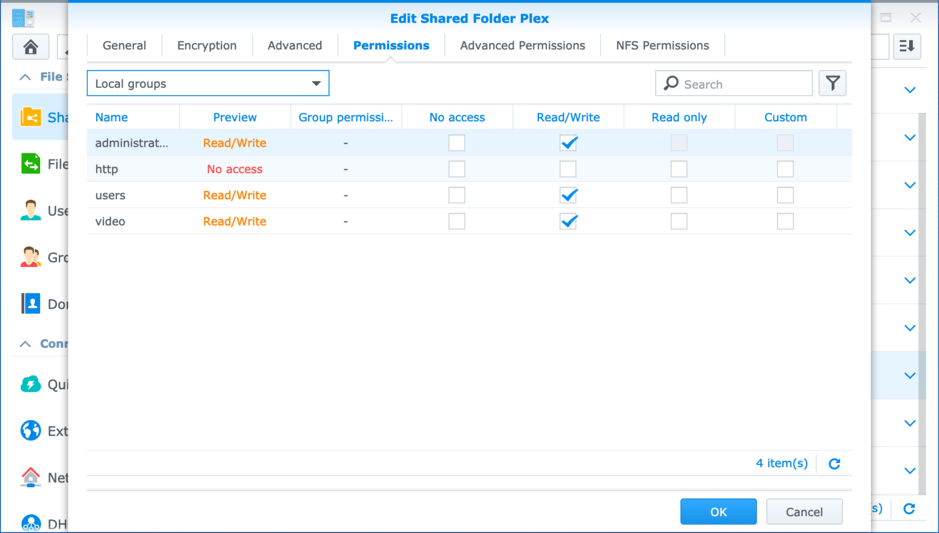

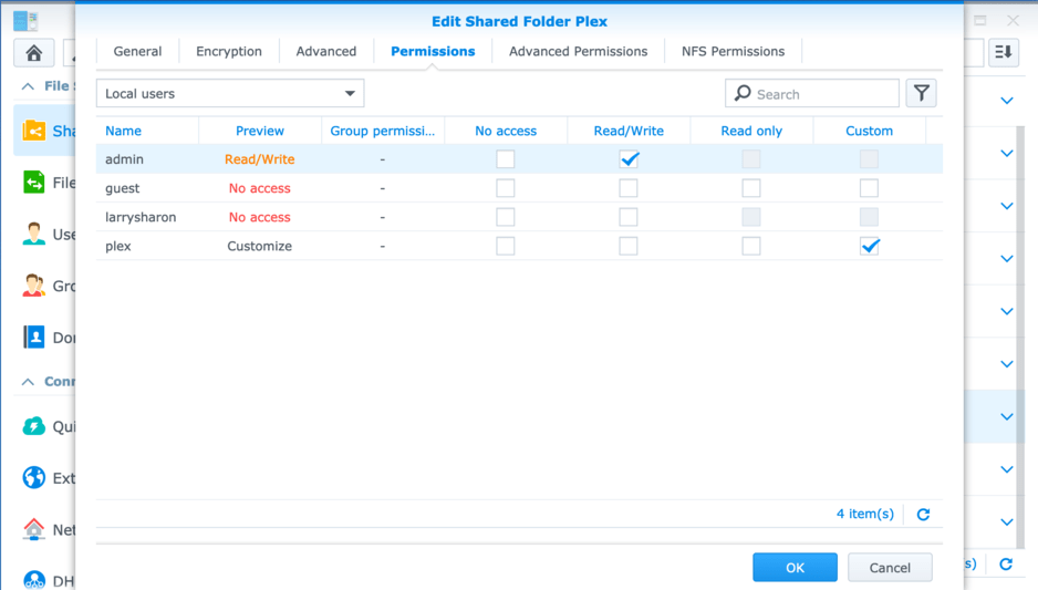

Please see attached screenshots. The Movies and TV Shows permissions look exactly the same.
You are correct on 1 and 2.
For number 3 this is my assumption because when I grant plex permissions the auto scan starts working again but I may be wrong her because the permissions are now granted and it’s still not auto scanning.
For number 4 I believe that larrysharon, plex and admin all have access to the Plex share.

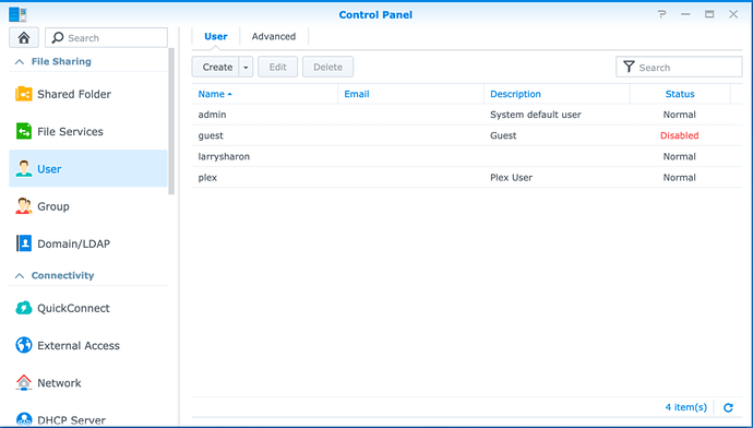

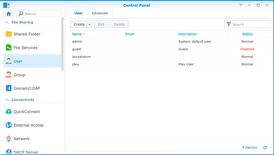

Are there two “Plex” users? (plex and Plex)
Please check.
If so, I know what is happening and we can fix it.
I don’t know what causes it but will drive things nuts.
No it looks like there’s only one plex user. Please see screenshot below.

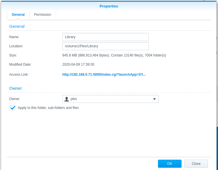

  10. You want user plex (notice the lower-case name) to be the owner of Library as I show below
  11. Also check the box for Apply to this folder, sub-folders and files.

I followed your instructions and was able to complete each step without any issues so Plex is back up and running. The one thing I noticed is that when I went into properties the user was not plex.
I went ahead and changed it to plex and checked the box.
This is what the Plex share permissions tab looks like after I followed your instructions.

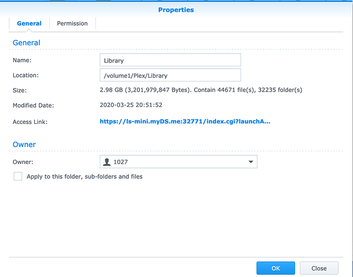

Also, after latest update this is how permissions look in the Plex share. I no longer have permissions, only the admin.
My apologies for the delayed reply.
Seeing 1027 tells me it did not have a known UserID for the Plex share.
Something was internal and playing with the system.
