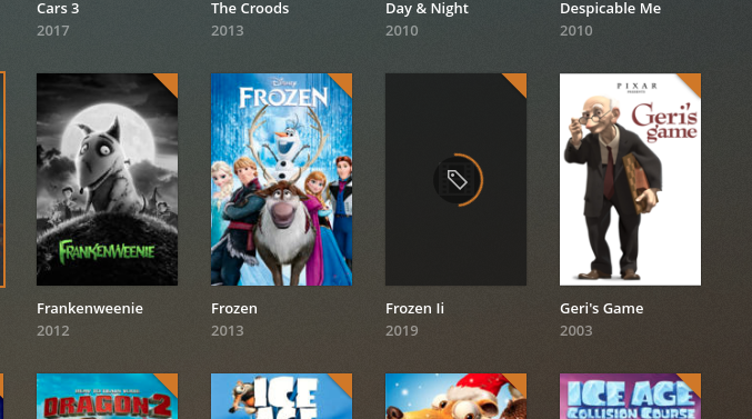

I am having trouble replicating the problem.
Here is from the DS418j
  1. PMS installed on volume1
  2. Some shares on volume1
  3. Animated share on volume2
Here, while still being copied, PMS has already detected the file coming in from the LAN.
