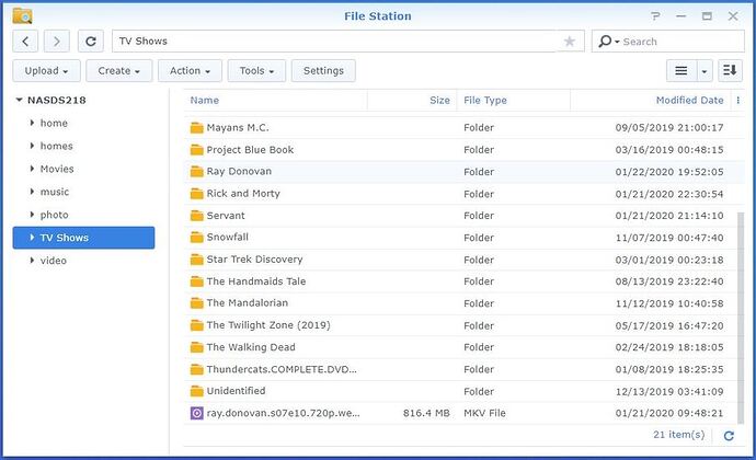

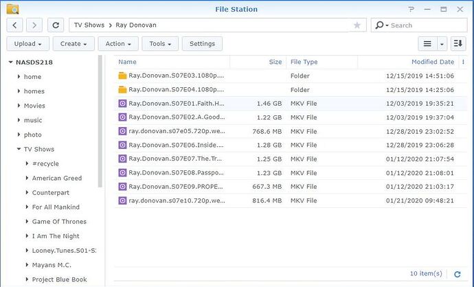

Actually just noticed that I placed the file in the root folder of “TV Shows” and not the subfolder for the tv series. It appears to only update library automatically when files are place in the root folder and not in subfolders. any idea what is causing this? Thanks! :confused:
If you /volume1/TV Shows as your top,
placed the file as `/volume1/TV Shows/some-series-episode.ext,
with it not being detected?
  1. permissions
  2. the inotify we ran into
  3. the existence of the Series/Season/episodes overriding it.
Here is an example
When the file is /volume1/TV Shows it updates automatically
But when file is in /volume1/TV Shows/Ray Donovan it does not
Attached are logs. Thank you!
Forgot to attach logs here they are
Plex Media Server Logs_2020-01-22_19-59-48.zip (2.2 MB)
