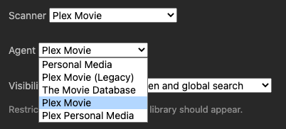

I keep seeing this error whenever I try to change the scanner. If I don’t upgrade the library, the scanner stays in place, but the error remains as seen in the screenshot. But if I upgrade, then the agent resets from The MovieDB and TVDB. And as you can see in the screenshot, it happens with both the Movie and TV libraries.
So you are seeing that message even when the library is set to Plex Movie/Plex Movie?
That’s definitely not expected. Could you try using a different browser or private/incognito mode and see if it still shows up?
Tried different browsers, tried it in the Plex for Mac app, tried it in incognito mode.
That’s very strange
Could you also just clarify what you mean here exactly. Note that this is exactly the correct behaviour, when upgrading the library it should switch to Plex Movie for the scanner and agent. TMDB and TVDB agents are legacy and not supported any more.
Once the scanner and agent is set to Plex Movie then the upgrade message should go away.

Oh okay, then this is a case of me getting things backwards. I thought Plex Movie was the legacy one. I’m very sorry.
