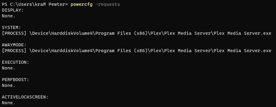

This is how it looks when Plex is currently playing an episode ^^
Plex off
This is how it looks the very second an episode ends and the 15 second countdown begins until the next, during that time the PC goes to sleep.
Plex used to keep the AWAYMODE: [PROCESS] there for around 1-5 minutes before it would go into Idle mode and register 0 active sessions.

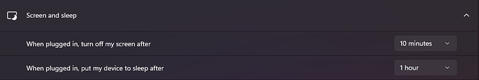

How is your power saving mode configured in the Windows control panel?
Balanced power mode and
