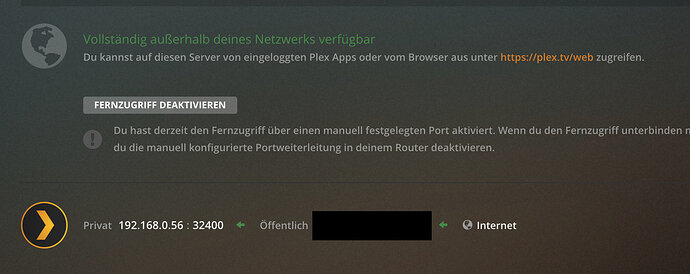

Hi there,
I’ve some issues with Plex Media Server on Synology NAS DS918+.
Hope I can explain this correctly.
The NAS is connected to my Fritzbox 7490.
The router is always giving the NAS the same IP Adress. In my case:
Fritzbox: 192.168.0.1
Computer: 192.168.0.2
NAS: 192.168.0.56
I manually forward all useful Plex (and other ports) trough my fritzbox for the IP 192.168.0.56
So far, so good. I hope.
Now, if I want to use Plex “on the go” with my Smartphone everything works fine.
UNTIL I add the second LAN Cable (to connect my brothers Fritzbox, IP: 192.168.2.1) so he could also use my NAS.

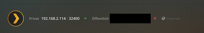

After a while the plex Media Server changes the Plex IP Adress to one out of the 192.168.2.X range. So my forwarding doesnt work anymore.

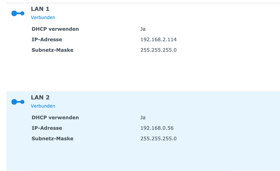

I attached 2 screenshots that shows both LAN Port configurations on the NAS.
The IPs are always the same. LAN2 is from my network with 35 at the end.
Portforwarding refers to that IP. Everything works fine, till i attach the second cable (LAN1) coming from another fritzbox with another subnet.
After a while the plex server changes to this IP, that I couldnt handle in my router and remote connection isnt available anymore.

I share the NAS with my brother, so that he can do backups and stuff. Therefore we connected one cable from my fritzbox to the NAS on Port 2 (IP 192.168.0.56) and one cable from his router on Port 1 (IP 192.168.2.114).
As long as I disconnect the LAN 1 cable everything works fine. I got my static IP, Portforwarding, Plex running, remote access works very well.
But… if I then reconnect LAN1, Plex (whysoever) changes the IP address (seen under plex settings) to this, which ends in remote access failure:
Hope this helps. Cause I couldn’t find out what I should do on my end in the fritz.box settings. Seems to me it has to be something on the NAS / Plexserver itself that I have to configure / fix.

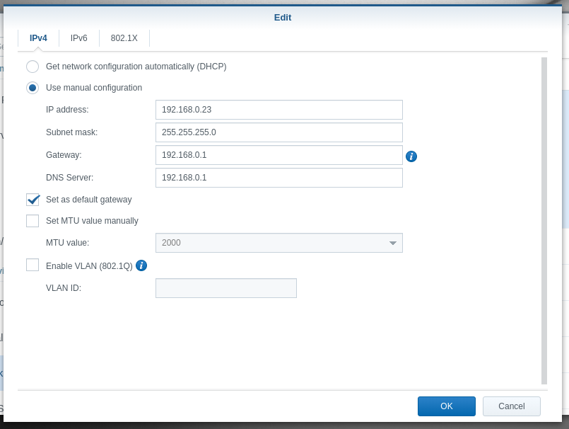

To make your Synology’s IP address status, you have two choices:
  1. In the Control Panel -> Network -> Network Interfaces
Here is how I have set a Manual IP (static)
  1. The other method is to copy the MAC address and assign a DHCP reservation in your modem/router’s DHCP server. This is more work but accomplishes the same result.
