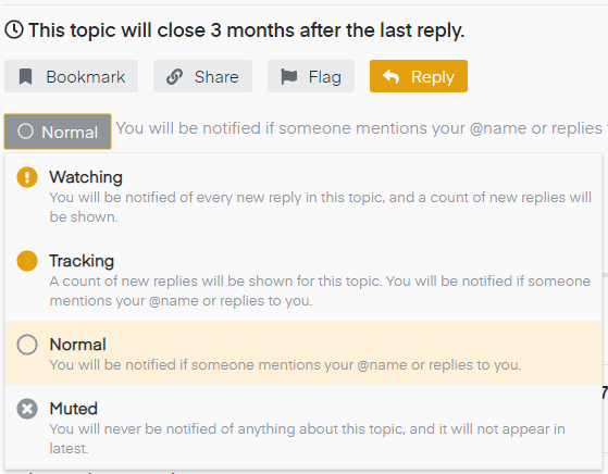

FYI, Easy way to follow/unfollow a thread: Scroll to bottom of thread, click on Normal, choose Watching. Change to Normal when you want to stop.
Screenshot%20(240)
