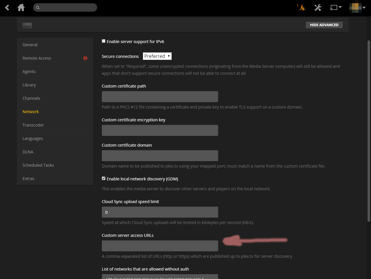

If you put your correct IP adress into the field I highlighted in my secreenshot, the server will publish it to plex.tv from where your clients will get it automatically.

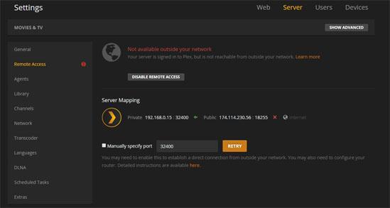

See the picture below:
Under server mapping “Public IP”
you need to set the check box. Unless you do, PMS will keep on trying to establish a port forwarding per UPnP, using a random port number. Which is not what you want if you define the way of the data to go through your VPN.
  • the connection test on that page will probably never give you ‘green’ status with a VPN. It was not designed to handle a VPN.
you need to check the reachability manually from the other end of your VPN.

From what I understand setting the custom server access Url should do what you want. This appears to be the way you can specify the public ip address rather than Plex determining automatically (and incorrectly if you are running a vpn client on the same box).
However, I have tried this too and it doesn’t work for me either.
OK so its not just me then THANKS - Perrottg for confirming… Although you did help I made a mistake saying your quote answered the question…
