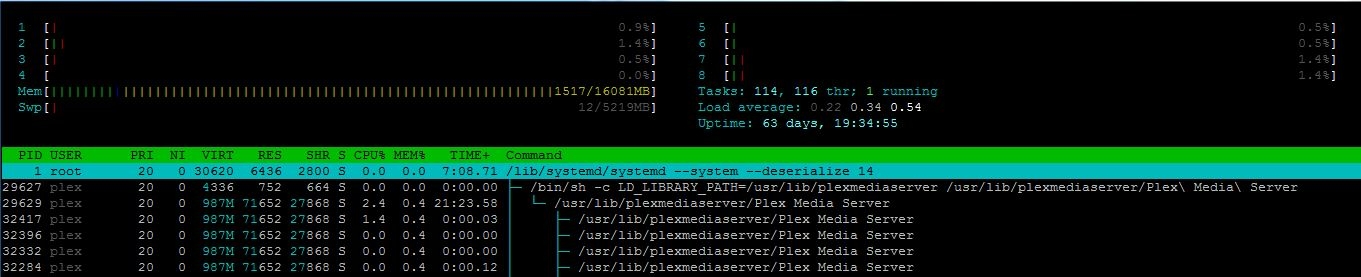

Not a VM but an old HP Proliant Xeon server and not taxed at all… aside from when multiple transcodes occur this is the normal idle state which is what it was like at the time of the hangup
