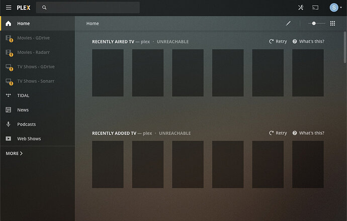

This morning, I went to try and load up plex on my desk. Immediately, I noticed that nothing was loading and it was saying it couldn’t connect. I found this odd, and looked at the system log for the upstart service and noticed that a plugin was throwing a bunch of errors. I removed the plugin and tried to restart plex. Still had no luck.
I tried the troubleshooting steps here: https://support.plex.tv/articles/204604227-why-can-t-the-plex-app-find-or-connect-to-my-plex-media-server/
And was also forced to even log back in to plex before I had the chance to complete them. I can connect directly to the server, but I don’t see any issues as to what is preventing Plex from connecting. I have literally not changed any settings or configuration on Plex in months (plex does auto update to the beta version). So this change baffles me.
plex_not_found.log (54.1 KB)

In this case, I am accessing the server remotely, but, it was playing an episode of Dave Chappelle for ~1.5 hours, and then the video just abruptly halted and stopped playing. Then the above errors started occurring from the agents.localmedia plug-in.
If I go into a library, it asks me to attempt with an insecure connection, and if I hit Allow Once, it attempts to connect and fails.
If I try to do it locally or remotely, using plex.tv or the host’s local domain (plex.localnet) it fails to load anything.
Once I restart the service, it works fine.
