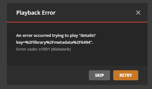

In addition to the issue with the settings pages, I encounter this error when trying to stream a movie from the webapp:
If I press skip in that dialogue my movie plays as expected. I do have a pre-roll video for movies, selecting that video directly from my movie library behaves the same way (shows the error, skip, then plays my pre-roll video). I can’t get to the settings pages to test with pre-roll disabled.
EDIT
I did some more testing:
- I can stream TV shows without issue
- I can stream Movies which are marked partially watched if I resume where left off
- I cannot stream any Movies from the beginning without seeing and skipping the error above
This would all seem to imply that either my youtube streamed trailers or my local pre-roll for Movies are causing an issue. I would test disabling both of these features, but for the issue of all of my settings pages also displaying an error. Looking at the requests in the chrome network tab, I consistently see a 404 response to path/system/:/prefs when trying to load a settings page.
END EDIT

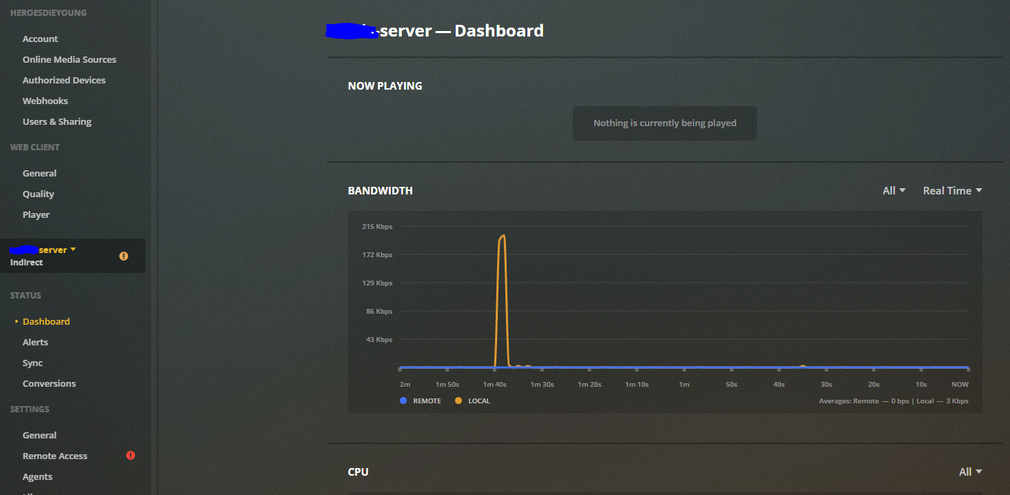

The server not allowing you to see Settings - Server indicates one of two conditions:
- Your Plex/web session isn’t signed in with the same Plex account ID as the server
- The server isn’t signed in (claimed) at all.
I see in your logs where it authenicates as you.
Oct 01, 2019 08:27:16.833 [0x7f386dd5f700] DEBUG - Auth: authenticated user 1 as HeroesDieYoung
Oct 01, 2019 08:27:16.833 [0x7f3835ffb700] DEBUG - Request: [192.168.1.11:45277 (Subnet)] GET /video/:/transcode/universal/session/48ce061f-7d10-4641-a09e-950d8c1f1177-329/base/01458.ts?protocol=hls&mediaIndex=0&waitForSegments=1 (8 live) TLS Signed-in Token (HeroesDieYoung) (range: bytes=0-344063)
Looking at what Plex.tv knows of recent activity, I see two servers
*******-serverwhich was last seen a few hours ago -
*********Rainwhich was last seen some 4 years ago.
Does this make sense to you?

I am 100% confident I am logging in with the same Plex account. I’ve been a plex user for years and years, I’ve only ever had the one account.
I also cannot imagine any way #2 could have become possible. This isn’t a new server. It has been operating as a Plex server for years. The issue began immediately after upgrading to 1.16.6-1592. I am now running the latest 1.18 build and still having this problem. I can’t see server settings, but additionally the server doesn’t download metadata for any new media.
My take on this is that the settings issue is a side-effect of a deeper issue, rather than the typical login-mismatch that keeps being brought up.
My current issues are:
- Server settings pages are unavailable
- Metadata is not automatically downloaded for new media added to the server
- My pre-roll clip could no longer play after upgrading to 1.16. I have side-stepped this issue by editing xml directly to disable that feature.
The only next step I can take without some team-member guidance is to do a re-install. I’d hate to have to do that and lose my history of which content has been watched. Not sure what else to do here to get assistance though. I’ve been as responsive as possible and provided everything asked for.

I can’t see all the information about the server because you did a metadata refresh which fills things up in a few minutes.
Would you restart the computer, then give PMS 6min to initialize, then try to connect to it using the https://local.server.ip:32400/web and then download new logs? Thanks.
