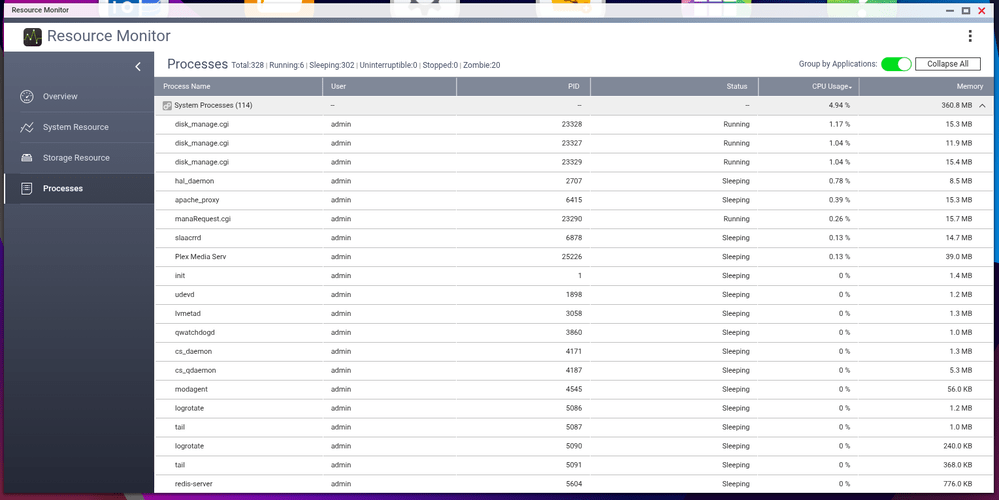

start resource monitor, look at the different activity indicators
You’re looking for both PMS consuming CPU (a fair amount)
–AND–
fairly steady, elevated, disk I/O as it upgrades the DB.

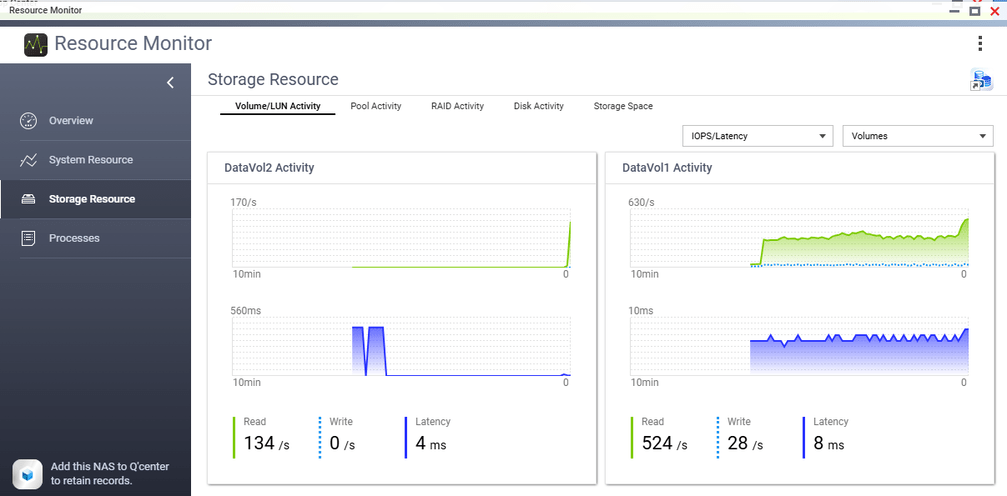

Upper left corner (the master start menu)
This will show you how busy the disks are.
If you’re hearing access, that’s a good sign. You might just have that much work to do with so many files.

OK got the resource center up. Not seeing much activity at all. Under Plex Media server it says sleeping as it does with almost everything else. CPU usage is 0% against almost everything.

OK, things seem to have picked up. Attached are three screen shots for you
..steve
It’s still crunching along, as I suspected.
On the Storage page, in the upper right, change IOPS to Throughput.
It will be a more useful report.
As it currently shows, 524 iops is pushing the HDD to their limit
(It’s I/O bound)
Just let it keep running and you’ll get there.

How do we know this PMS causing this and not something else. Can we check PMS is running and not locked up?
..steve
