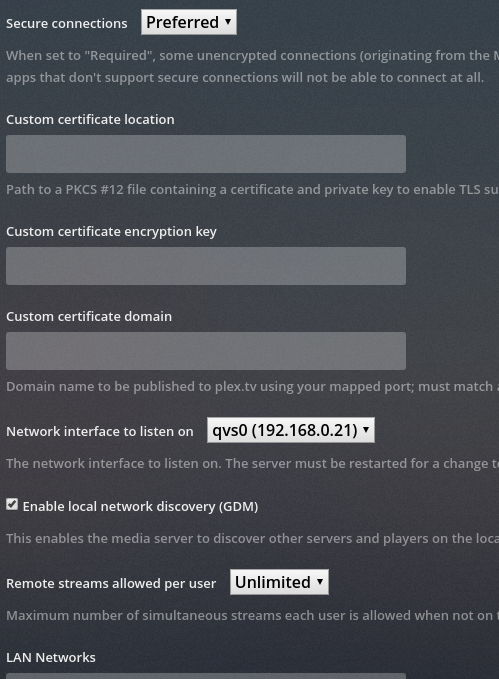

Do you have PMS set to listed to a specific interface?
Aug 09, 2018 17:58:19.479 [0x14e99bd61800] DEBUG - Network interfaces:
Aug 09, 2018 17:58:19.479 [0x14e99bd61800] DEBUG - * 1 lo (127.0.0.1) (loopback: 1)
Aug 09, 2018 17:58:19.479 [0x14e99bd61800] DEBUG - * 100 br0 (172.16.0.48) (loopback: 0)
Aug 09, 2018 17:58:19.479 [0x14e99bd61800] DEBUG - * 101 docker0 (172.17.0.1) (loopback: 0)
Aug 09, 2018 17:58:19.479 [0x14e99bd61800] DEBUG - * 119 virbr0 (192.168.122.1) (loopback: 0)
Aug 09, 2018 17:58:19.479 [0x14e99bd61800] DEBUG - Creating NetworkServices singleton.
If you don’t have it set, it can easily drift to the other adapters.

As of the latest upgrade, the internal network handling changed.
If you notice, you actually “Select” which ethernet adapter to Listen (bind) to.
This is they key.
As experiment, create an ethernet adapter alias for your computer’s ethernet adapter.
Now you can cycle through which adapter to bind to because you’ll have access to it via eth0 and eth0.1 (the alias)
Really? I can’t recall ever having seen this before, I’m even spinning this up in an ubuntu 16.04 LTS and I’ve not seen it say anything during setup with the NIC… is this in server settings?
PMS 1.13.5
Settings - Server - Network - Show Advanced
I’ve been pushing for this for almost 2 years now.
