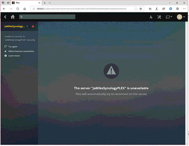

Have a Synology DS1815+ running a fresh install of Plex server 1.13.5. Suddenly it’s offline after a day or so of working fine. I’ve made no system changes other than to be adding my movies to the single library I have configured at the moment.
Can logon to the servers IP address but even connected there the server shows unavailable.
I’ve tried reinstalling and no dice. It was working great then all of a sudden…nothing.

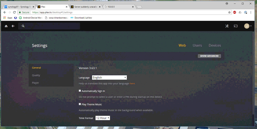

Here’s what I see both connected directly to the NAS as well as at plex.tv
I’ve restarted the NAS several times as well as stopping and starting it. This has happened multiple times as I’ve reinstalled 3 times now. Every time it works for a while and then suddenly stops.

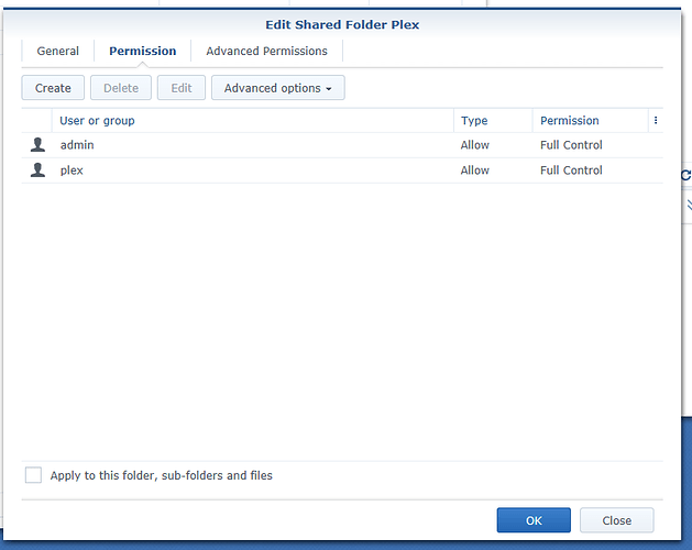

Go to Control Panel - Shared Folders - Edit the Plex share – Permissions – Give your username R/W permission to it.

Shared folder permissions for Plex… I went ahead and pushed the permissions down to the subfolders and files just to be sure.
After another restart I could load the server and my libraries, but trying to edit tags, or play anything times out and I get a message like “error opening item” or something. I’d add the specific error here but it’s offline again.

Instead of accessing it through Plex.tv, open it directly http://10.0.0.5:32400/web
If your computer is not on 10.0.0.x subnet or you are remote please tell me

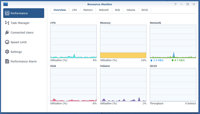

In addition to Plex I also have Docker with a Ubiquiti AP. This as well as all other functions of the NAS seem to be operating normally. PLENTY of available resources.

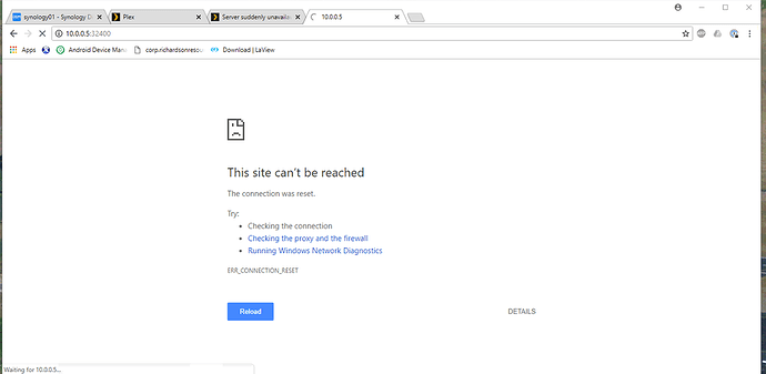

Now the server isn’t responding at all on the local port… FML.
