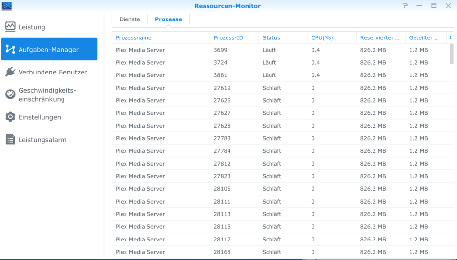

To add to this… PMS works fine on my laptop, but the second I use an AppleTV to enter the live DVR or recorded shows, the server crashes.
If PMS is crashing, as in: the process itself is actually gone (Resource Monitor -> Processes doesn’t show Plex), then I would like
- The ZIP log files containing the most recent crash
- If there are Crash Reports in Plex/Library/Application Support/Plex Media Server/Crash Reports, please make a ZIP of them too and add here with the Logs.ZIP
This thread is focusing on Synology. If PMS is crashing for Windows, please create a fresh thread to avoid confusion.
We think we have the root cause already and are focusing on the data we have in hand.
