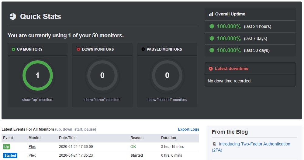

I personally use uptimerobot.com for monitoring externally.

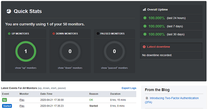

@gorgarp123 Thanks for mentioning uptimerobot.com. Signed up earlier today. Really nice dashboard and detail page. It’s been running for all of 8 hours, but so far so good. Thanks again!
