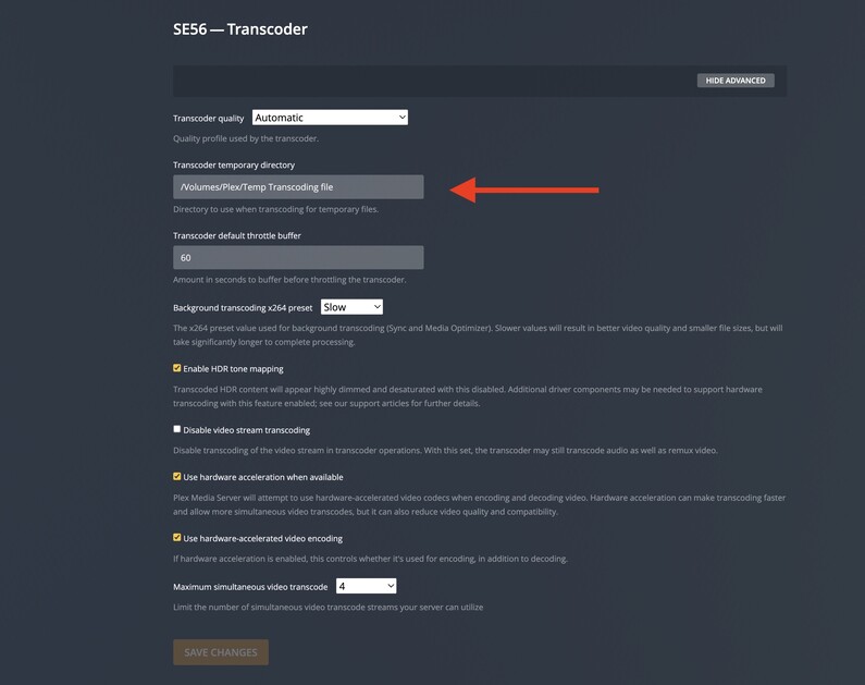

I don’t use a mac myself but I would suggest maybe stopping plex, delete everything under /Users/davidm/Library/Application Support/Plex Transcode Folder/Transcode and start plex again and see if this helps. Also, double check permissions on these folders …

Personally I would not have a Trans code directory in that location / Root Directory.
I would have it anywhere else. On another drive like I keep my custom Posters, photo backup etc

Thank you for the feedback. I will move this. I placed it here to be on the SSD drive but will move it to the second drive.
Well, damn. Still crashing on me. I haven’t moved my Transcoding directory, but will do that now…perhaps that will trigger an improvement. I just can’t figure out what is causing the crash.
