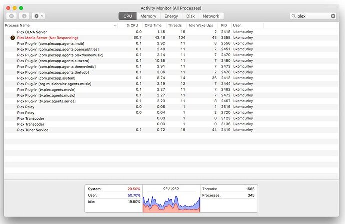

Plex won’t even start today just crashes straight away, restarted Mac multiple times no idea what’s causing this. Restarted modem, network switch too - still just ends up not responding. None of the crashes are appearing in the Crash Logs folder.
Mac OS 10.13.6, and Plex Server 1.30.1.6497-5fc2e0894.
Get the lovely spinning beachball over the Plex finder menu bar icon, and Activity Monitor just says (Not Responding). Is there any terminal command I can run to see what’s going on?
I think I’ll create a new thread for this, as my issue is in MacOS and this is tagged with Windows. I also just disconnected all external hard drives and have Plex Server started now, looked at logs nothing pointing to any specific file causing issue, but suspect that’s the cause. Will add each drive one by one to see issue.
