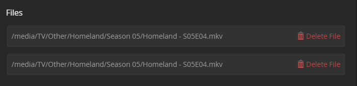

Using the latest Ubuntu version 0.9.12.16, but I did see this in earlier versions. I’ve noticed in the web interface that all newly downloaded episodes of TV shows have a little “2” in the corner, indicating that Plex thinks there are two distinct versions of the asset. However, when I do a file info in the UI, the two entries it shows have the exact same file path. For instance:
The latest episode of “Sleepy Hollow” give me this in the media info popup in the webUI:
Files
/pub/Media/Video/Television/Sleepy Hollow/Season 03/S03E04 - The Sisters Mills.mkv
I only notice it for episodes added in the past week, so this may have started in version 0.9.12.13 or .14 (I think I skipped .13, so that’s why I’m not sure about that one).
A rescan of the library did not fix it, but it didn’t cause older episodes to get duplicated in the database.
Has anyone else noticed this?

Just a clarification for my issue, which I think the others are seeing: There is actually only ONE file on the system. Plex indicates TWO copies, checking Info shows two files, but he directory paths are identical and point to the same file. Seeing this more and more often. I’m using a docker version of Plex with unRaid and as mentioned before this is happening randomly with some shows. Hasn’t happened with Movies for me.

The steps you outlined are more than are necessary to work around the issue. There is no need to duplicate/move/delete the file. Simply rename the file to an unrecognizable format (ie: “Modern.Family.S04E20.mkv.OFF”, allow Plex to “see” the file is “gone”, then go back and rename the file back to it’s original name (“Modern.Family.S04E20.mkv”). Plex will “see” the file and add it back, but this time it will only “see” 1 copy, not 2.
I’ve followed this process multiple times with success. If you are finding this doesn’t work for your situation then apologies in advance.

I’m having this same issue and it’s preventing me from casting to Chromecast. I can play the correct version of the file using the web client, but as soon as I try to cast that version Plex complains about not finding the file. Plex also thinks I have 3 different versions of the same episode and refreshing, restarting and updating the plex server doesn’t fix that.
