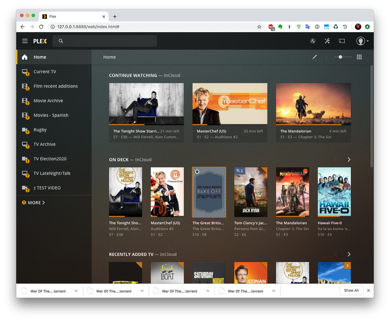

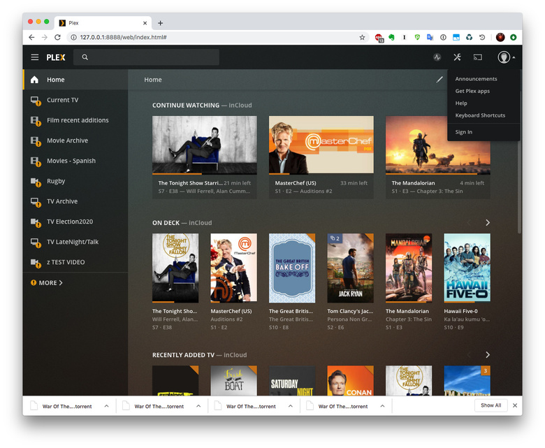

After selecting continue setup, but still not logged in, Plex shows the server libraries and icon upper right shows not logged in:

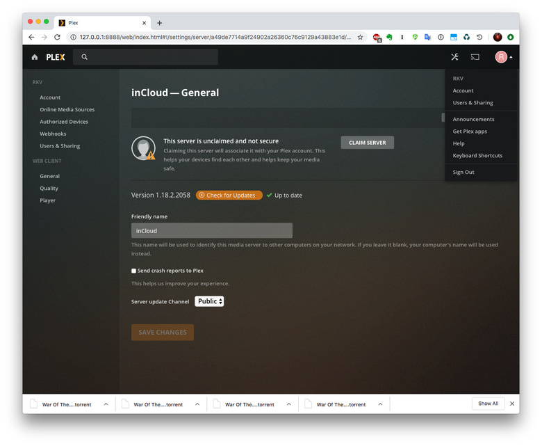

I then login and icon in upper right reflects change, thumbnails still displayed:

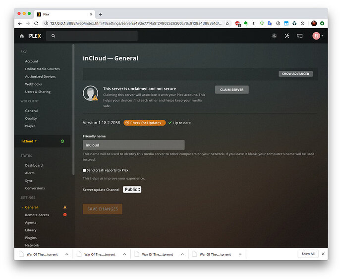

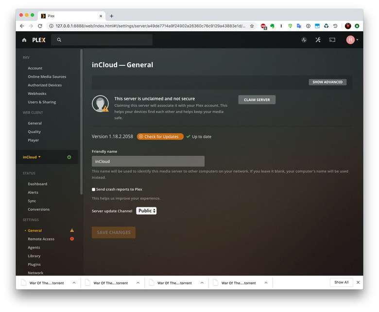

I then go to settings and the server inCloud is visible but showing as unclaimed

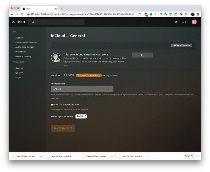

I then attempt to claim the server and for a long time see spinning circle in claim button. Also note server no longer in sidebar.
I next see this screen. In only one instance there was a transient popup indicating error while claiming server. Although, in most attempts no transient popup is displayed. In all attempts I’m left with this window.
I am still logged in

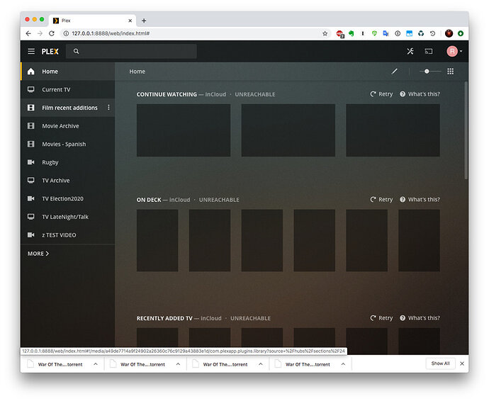

If I go to the main window, I no longer have thumbnails:
If I attempt to select a library, I see this:

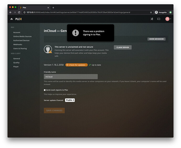

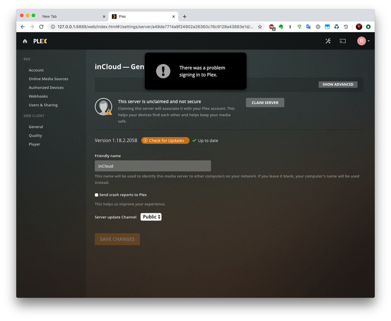

Was finally able to capture transient popup:
Note, even though it gave this error, it is updating the preferences and logging in the user. This time I attempted to claim prior to signing in. That may be why I didn’t see it all of the time. Most of the time I have signed in first and then tried to claim.

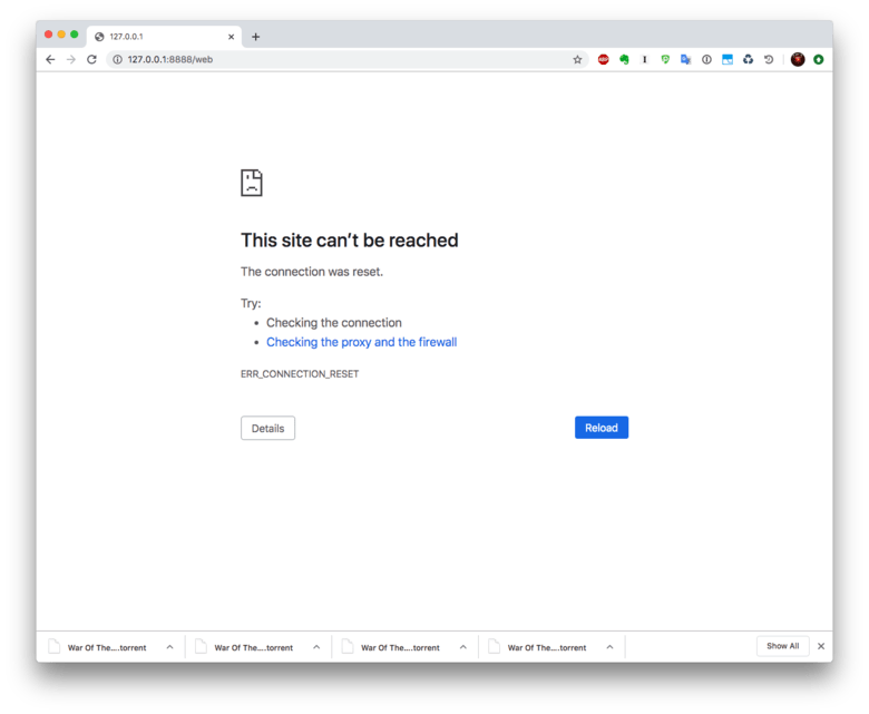

regarding being unable to open the server’s web page:
  1. ssh -L 8888:127.0.0.1:32400 ip.addr.of.host
  2. Sign in and let the ssh session sit idle.
  3. Now open http://127.0.0.1:8888/web in an incognito browser window
I stopped Plex Media Server, made edits to Preferences.xml, restarted Plex Media Server and used an incognito browser window. The screen sequence was identical to that previously posted and here is the result:
This time I went straight to Claim Server rather than logging into the account. I was prompted to login to Plex. As you can see the window upper right reflects that it did login the user, yet Plex warning claims “…problem signing in to Plex”. How is that possible?
I am assuming the following quote was with respect to whether I had connectivity to your servers.
Doesn’t the successful signin to a user prove connectivity?
