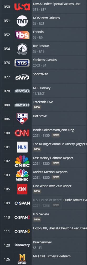

Added my tuner back after DB crashed and had to start over. I have disabled a bunch of SD channels on the HDHomerun itself.
Plex sees that these channels re disabled just fine as when I go to the “enabled” list, it 1:1 reflects the channels that are available.
However when I view my Live TV & DVR Guide, I get channels that are disabled.
Ex enabled list starts at 101
Live TV & DVR Guide starts at 50
I have tried to remove DVR, delete DB & Cache, restart server & hdhomerun, and still this issue prevails.

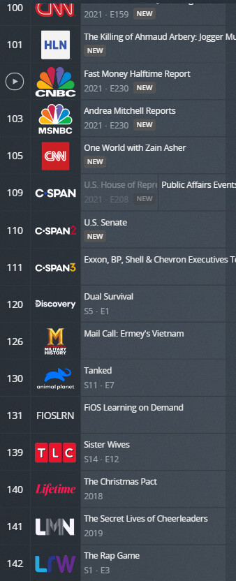

The suggested refresh guide does not work. The EPG page is correct in what it should show versus what is setup in HDHOMERUN tuner.
However, when you go to “Live TV & DVR”, the channels displayed do not match.
To be clear, my EPG & Tuner starts at channel 101, all channels below that are disabled on HDHOMERUN itself.
You can see my screenshot:
I will PM you more information as requested ASAP.

I can see from one of your screenshots that channels below 101 are showing

Setup for epg is ok. When you view the actual library is when Plex decides to show more than what was setup. I don’t know how else to be clear about this along with my screenshots.
This happens across all of my devices. Android app, ccwgtv, Plex web local & hosted, Plex app, Plex media player app, etc.
Delete the tuner, restart Plex service, restart hdhomerun, etc do not resolve the issue, so I don’t know exactly how you are “fixing” this by resetting your app. I’ve had this issue on going for months, a simple restart at this point is out of the window.
The screenshots are from Plex web. Strange you can’t reproduce when myself and another user have been reporting the same issue.
