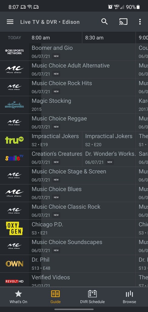

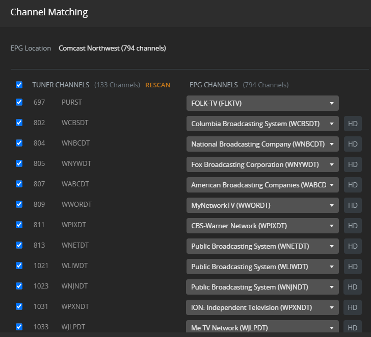

Here’s the issues. Since the server updated to 4707, the Guide has been completely screwed up. It’s not displaying the correct guide to match the “Channel Matching” of the tuner. I have a lot of channels turned off on the tuners. When i download the guide, the channel matching shows me everything correctly, but the Guide is showing a random list of channels that are not matched.
Here is the beginning of the Channel Matching list:
Here is what the guide is showing:
I can’t tune to any of those because they are not enabled. It does show 802-813, which I can tune to because they enabled, but then jumps to 1048 and skips a majority of other stations.
I have tried deleting the DVR and reinitializing the tuners, but it’s not solving the issue.

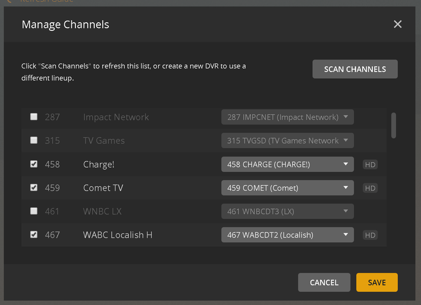

I’m also having the same/similar issues. I have an HDHR Prime. 1) Channels which are not even detected by the tuner are showing up in the guide. 2) Channels I have disabled in DVR settings (both on the HDHR itself, and in Plex) are showing up on the guide.
Channel settings in Plex:
Guide:

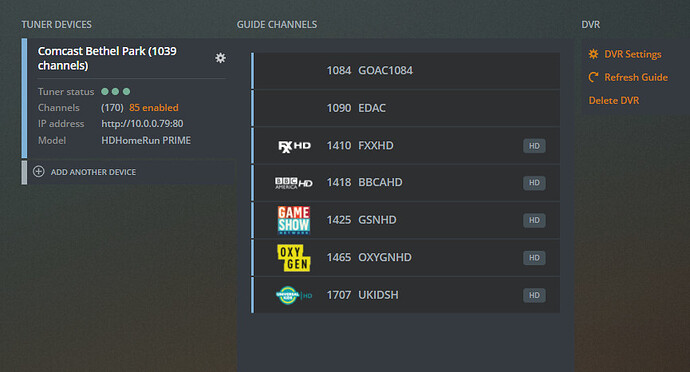

I can confirm that rolling back to Version 1.23.2.4656 (from 1.23.3.4707) and reinitializing the tuner also worked for me. I also have Comcast service with an HDHomeRun Prime and cable card, as others with the problem have pointed out. The problem only shows up after the EPG is downloaded (the longest part of this process, of course), where I noticed that the “Guide Channels” only listed 7 matches for the 85 channels I had enabled.
It also appeared to record scheduled shows, but then hung at 100% complete, presumably because nothing was actually recorded. I didn’t notice anything useful in the logs, either – I just happened to make the connection when I got a useful error (something like “could not tune channel”) when I tried to play live TV from the web interface.
Since someone else reported that the “tuner status” showed too many tuners as in use – I think that the UI is just failing to be updated when an error occurs. When I looked at the tuner’s web interface, none were locked, and restarting plex “fixed” the UI display issue.

The fix USED to be, note the channel number that the channel ends up in the guide, usually the SD feed in the low 100s, then go to your selected channel with the 4 digit channel number and map it to the channel plex insists it is on, and you could view the channel again.
Problem is, now the channel mapping list omits the channel numbers entirely, so if you scroll the list you will see the problem channels in there at least 3 times, but no idea what channel number it is mapping to. If you guess right, the channel will work again, although in the wrong place on the EPG, if you choose wrong, “Cannot tune channel no parts”
