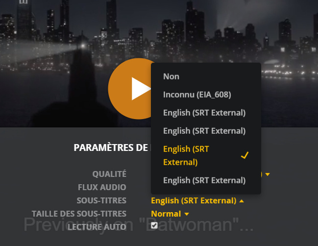

I have a problem that is not very serious but rather uncomfortable. When i want to select a subtitle for a TV Show (with browser, nvidia shield client, or else), Plex shows up all the subtile in the folder of my tv show, not only the subtitle with the same name.

So when i want to select a subtile, i have to try all subtitle to pick the right one.

I assume you have SubZero installed?
Scan: Which external subtitles should be picked up
Exact: Only if media file and subtitle files are named identically
Btw. your naming schema is wrong. Don’t expect it to work correctly forever.

I use Subzero, i modify the “Scan option” as you said, but same result. Maybe I have to refresh anything ?

While i was writing the answer above, the metadata refresh ended and it works, only the right subtitle shows up, due to the “scan” modification in SubZero.
